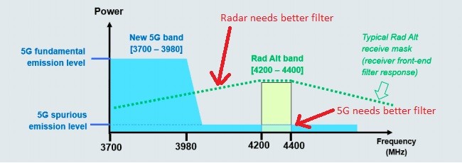

                    I think this helps explain it.

                      The 5G filtering depends on where that spurious emission level is an issue if the radar altimeter front end rejected the main signal frequency band.
                      IOW, if the rad alt front end cut off was at 4000 MHz, would there be a problem.
