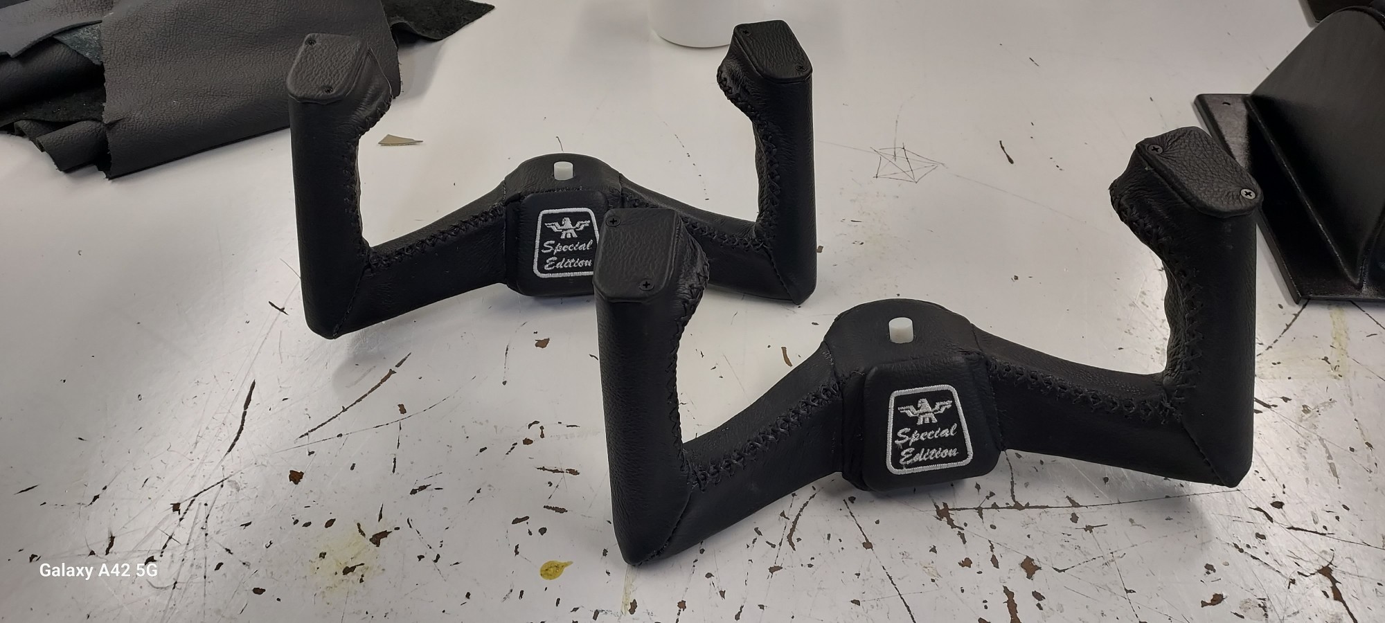

    Update.
    The long middle period where there are more and more wires is pretty much done. The wires have been bundled. Connectors are installed. Shop is working on the panel layout. All the rocker switches have been converted to toggles.
    Yokes are covered in leather by the interior shop and got installed on Friday.
    Once the panel layout is done, they will cut the panel, powder coat and etch. And then everything gets installed. A couple of weeks.
    The problem is, in 2 weeks I will be on a 2 week cruise vacation. And then home for a week and off and running for a week. If all goes well, I can test fly and pick it up that week. Then more test flying once I get back.
ID:	25565Click image for larger version

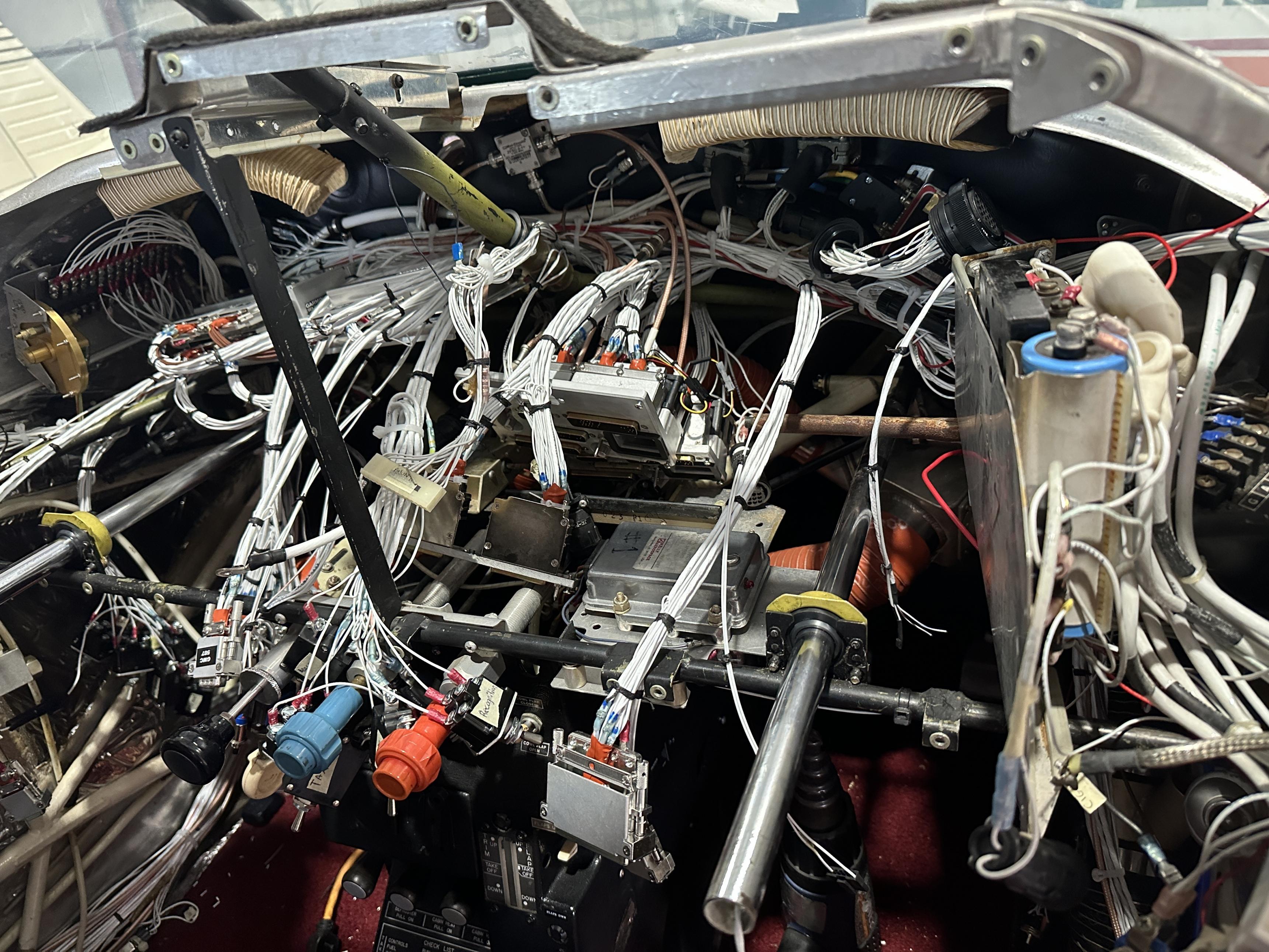

    Moving along, but the part where there is not a lot of visual difference from week to week. But all the wires are becoming harnesses with connectors and bundled.
    May make a change in the plans to put a 7" G3X on the right side instead of the AERA 760. This would give a full PFD/MFD for a pilot in the right seat, plus a full screen for engine when I want. OTOH, the AERA 760 is fully self contained with its own AHRS, so can provide AI and nav, but only GPS track (not mag heading) and GPS altitude. And no engine display. But can put engine display on iPad running Garmin Pilot.
    Any thoughts?
