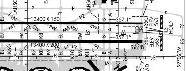

    KDFW is getting a new End Around Taxiway (EAT). I wasn't sure what it was until I saw the video. Are EATs a safety and efficiency upgrade, I'm not sure?
    I would hope that part of it means having a EMAS at the end of the runway to prevent an overrun from crossing the taxiway. Even so, I still have to wonder about the possibility of an airplane that's unable to gain altitude to clear the jet crossing under it. It's possible that they've crunched the numbers and decided while it's not impossible, it's extremely rare.

      As a safety measure, it only works if everyone rolls to the end. In which case it fails as an efficiency measure with everyone rolling out a 13,000' runway at 30 knots... and back. {EDIT: I suppose it doesn't have to effect the runway acceptance rate if everyone exits at normal locations onto the parallel in the wrong direction. Still means verry long taxi routes. ]

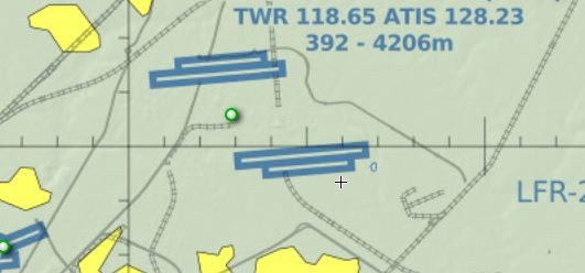

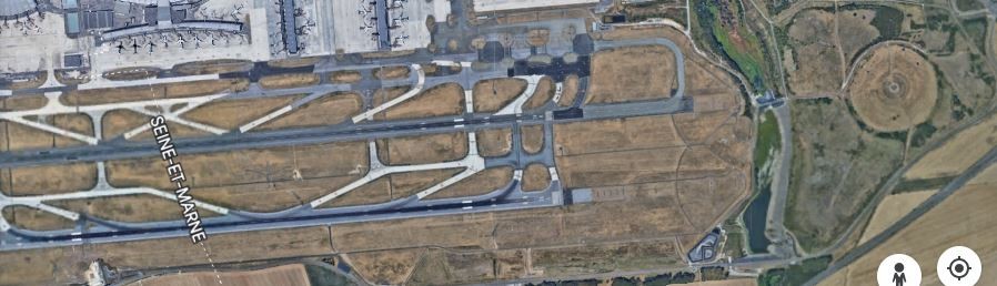

              CDG might work; seems to have the real estate, but they,in Gallic fashion, put the long runways on the inboard sides!
