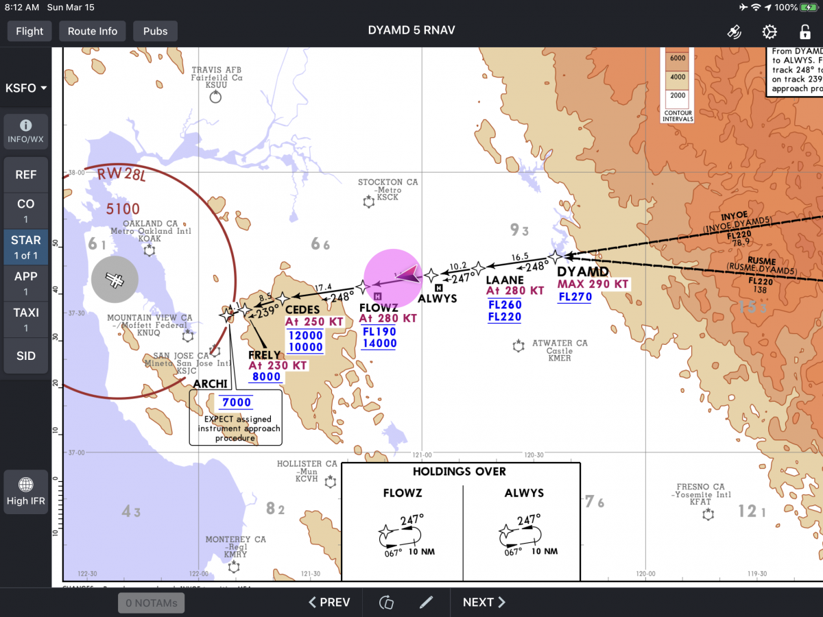

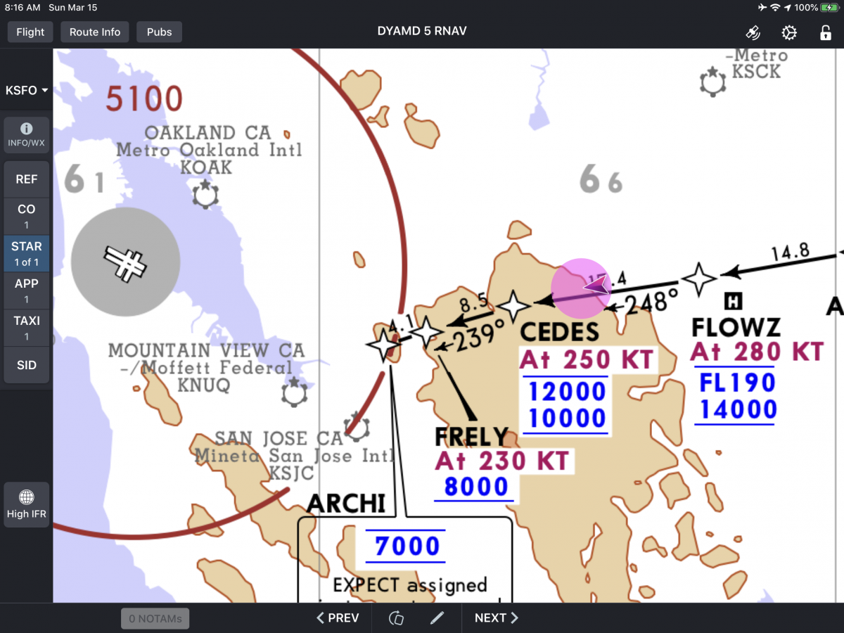

                            Here's an example of one of the reasons you don't use iPads for navigation.
                            Notice how the iPad is showing us off course in both images. We were not. We were exactly on course as indicated on our legally TSOd long-range navigation system.
                            If we were trying to fly the procedure via the iPad, we would have been off course.
                              Larry: I've had them completely shut down when using them for charts; not navigation. I carry two. Situation awareness and charts is what I refer to them for, but we had a Garmin 430 a 530 both WAAS and a GMX 200. With current data bases I might add.
