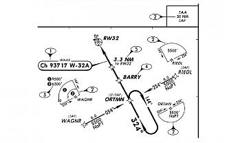

    In the above example when NoPT is not present on the inbound Track (WAGNR) can the aircraft turn inbound at the IAF (ORTMN) or must it turn outbound and follow the outbound track to reverse course?
      Bill -- If you are flying the segment from WAGNR to ORTMN, and there is no NOPT on the chart, then you must fly the HILPT. Were you cleared, for example, from somewhere southeast of ORTMN direct to ORTMN and then for the "straight in" approach, then you would not fly the HILPT (unless you received an express clearance to do so). And if you were vectored to final between ORTMN and BARRY you would not fly the course reversal.
        Unless I am missing something, NoPT IS shown on that plate between the IAF at WAGNR and ORTMN. Or are you asking what would be required if it wasn't shown? (Which Scott answered).
          Scott,
          Must the entry into the HILPT be flown as published, or can it be flown by turning outbound on a heading of 114 at ORMAN for one minute then a right turn to reverse course and join the 324 inbound course to ORTMN?
            John,
            I was asking "what would be required if it wasn't shown." I saw a similar approach (MWCR RNAV08) into a non-radar facility this week. It was the first time I had seen a HILT on an RNAV approach.
              Scott,
              You can use any of standard hold entries in to the published hold which would include the teardrop entry you proposed. The entry into a published hold is not mandated, only the hold itself.
