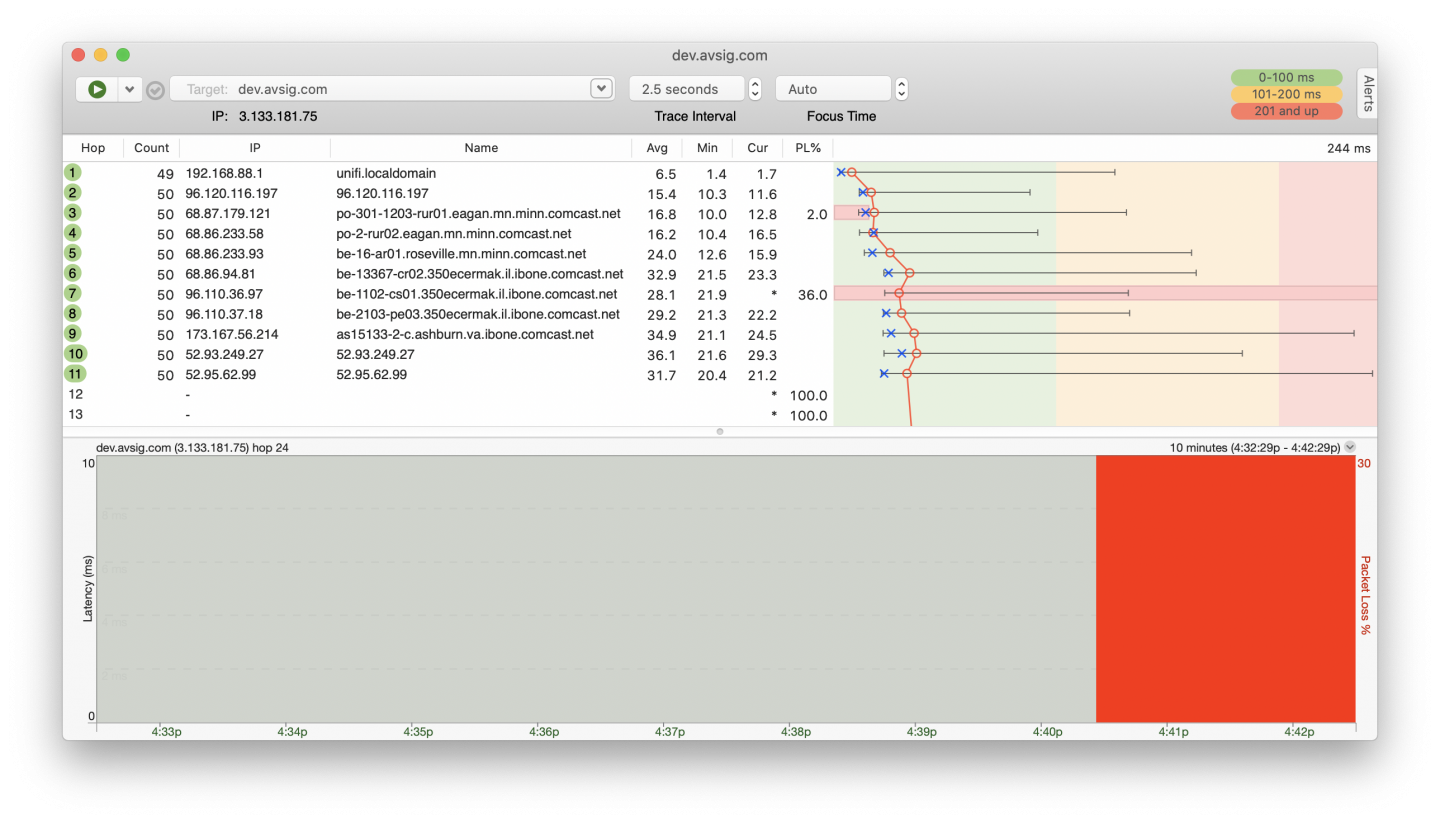

                • #38
                  I'm not having any issues reaching the forum. I'm also on Comcast. Here's a screen grab from PingPlotter -- a neat tool combing Ping and Traceroute output. The destination is unreachable with Ping, so ICMP echo must be disabled somewhere along the route, but at least it shows my path through Comcast to whatever network is 52.93.x.y
Name:	Screen Shot 2020-09-10 at 4.42.53 PM.png

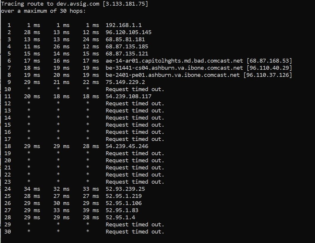

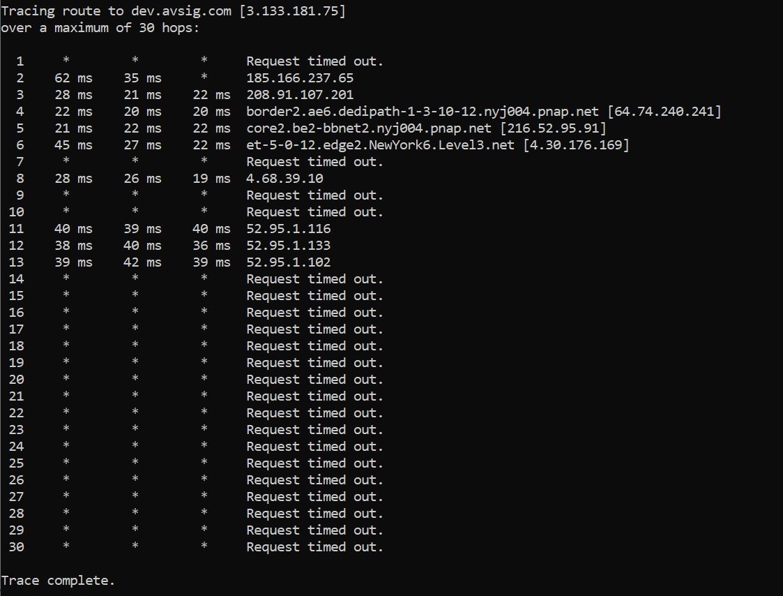

                    • #40
                      Here are my Tracert without and with my VPN.
                      The one starting with IP 192.168.1.1 is without VPN
                      Click image for larger version  Name:	Trace Route wo-VPN.JPG Views:	0 Size:	153.6 KB ID:	18644

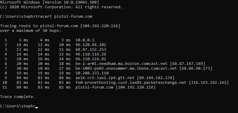

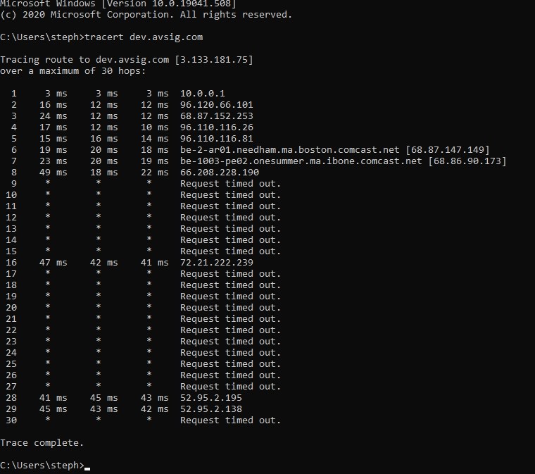

                              • #45
                                Open a "CMD" (aka DOS Box) and then do Tracert from there. When Tracert is done, it drops you back to the command line and the box stays open.
                                Thanks. It worked. Here's Avsig and the Pistol Forum for comparison:
                                I use Opera's VPN, I'm presuming that tracert is running outside of it.
