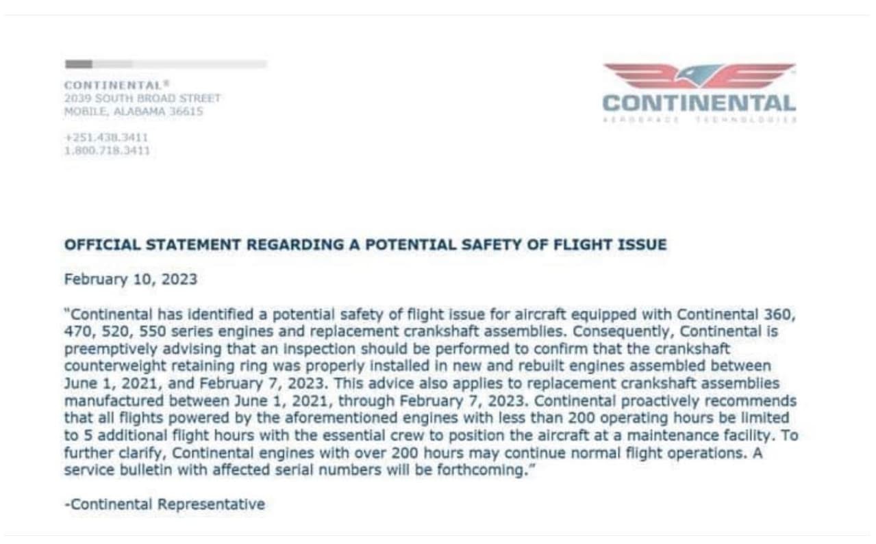

                    Continental released the following this afternoon: Bottom line, IO-360, -470, -520, and -550 engines with under 200 hours that were made between the previously mentioned dates. SB to be issued Monday, no AD at this point.
                    https://continental.aero/Potential-S...ght-Issue.aspx

                        Wow! Absolutely amazing language:
                        If you survived the first 200 hours, we think you should be okay.
                          Well, so far, the longest time in service for one that failed was 41 hours.
                          It seems they started with a very broad brush, and as they look more into it, they are narrowing the focus.
                            Terry,
                            I suspect they've figured out that if the retaining clip is installed incorrectly, it's going to crap out well before 200 hours. I don't know how many 470s will be affected; I don't think any OEM is installing them right now; AFAIK, Mooney, Beech, Piper and Cirrus are using 360/520/550s pretty much exclusively. I think it will affect anyone who had a Factory OH or ReMan during that period. Possibly those custom shops who sent their crankshafts to CAM or bought new crankshafts from them.
                              We recently (last spring) upgraded to an IO-550 from Air Plains in one of our C-182s. It's "on the list."
