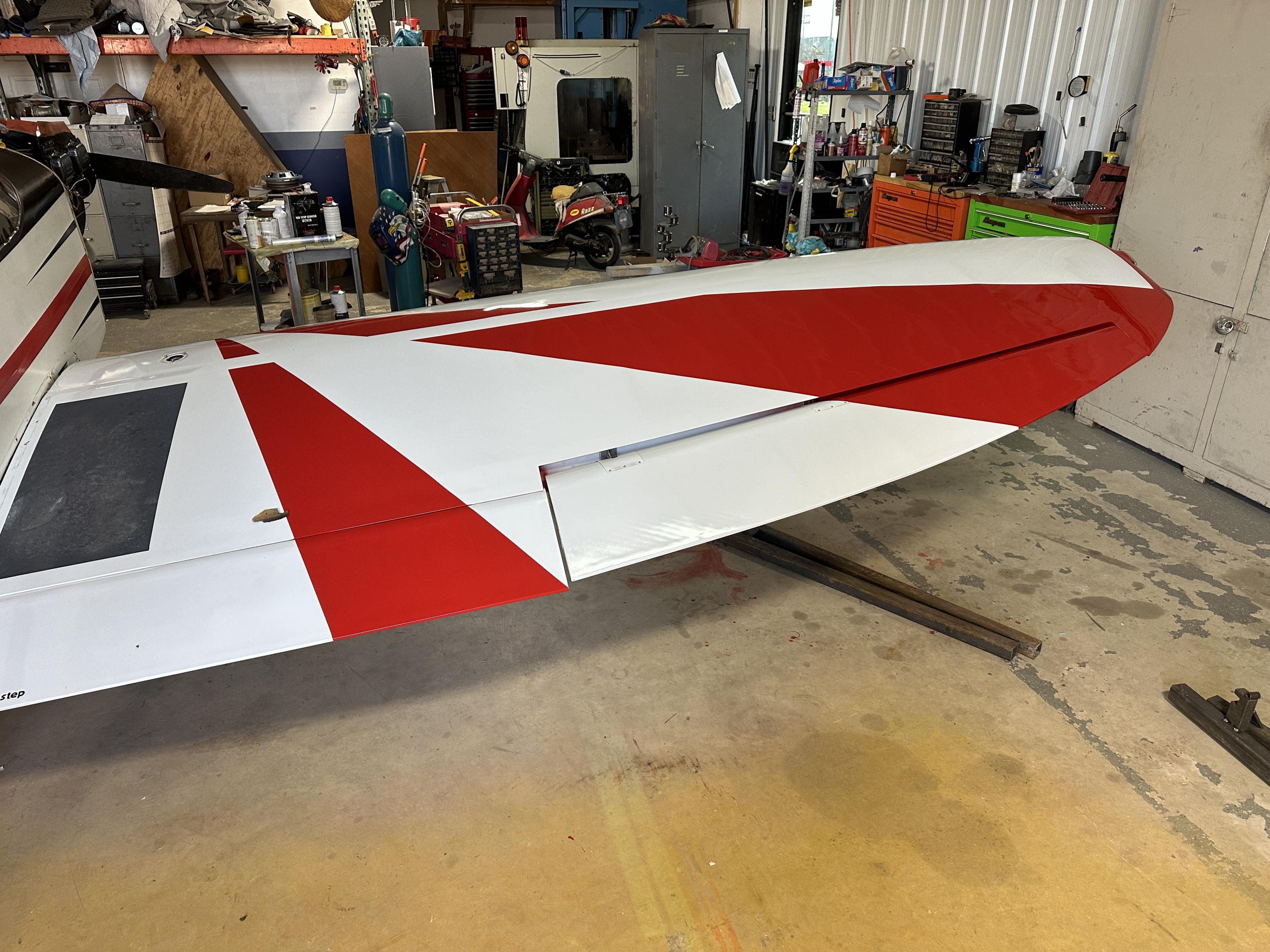

                  Got it washed and it looks better. Prepping to paint the wings and do some touch up. Then finish assembly.

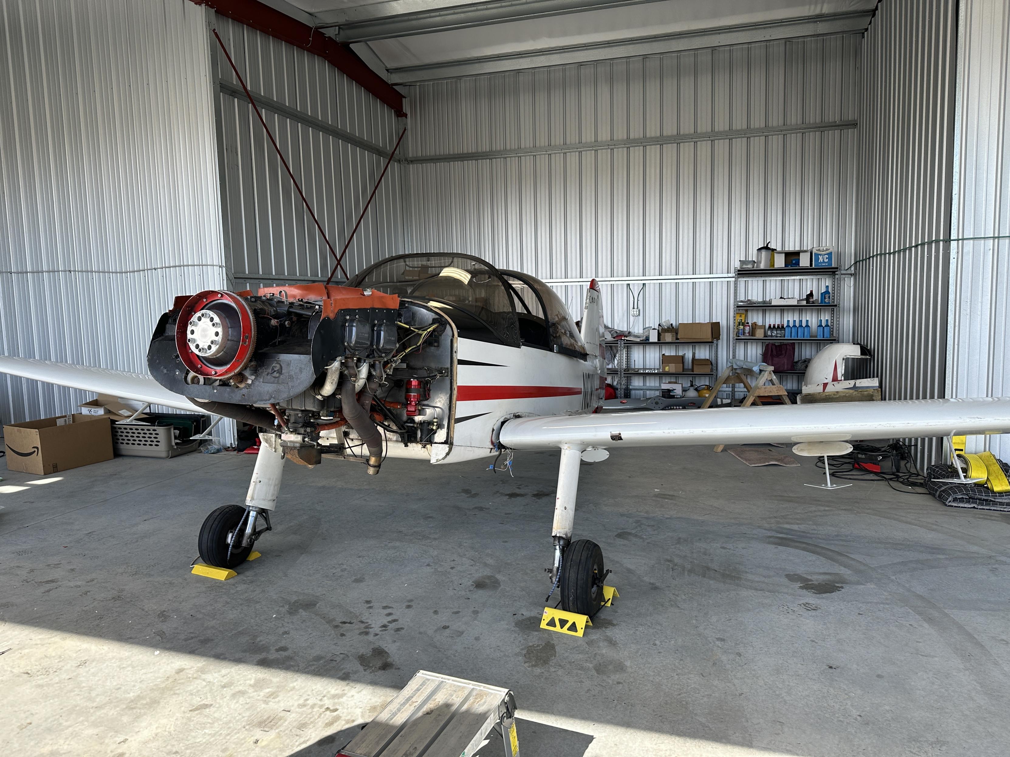

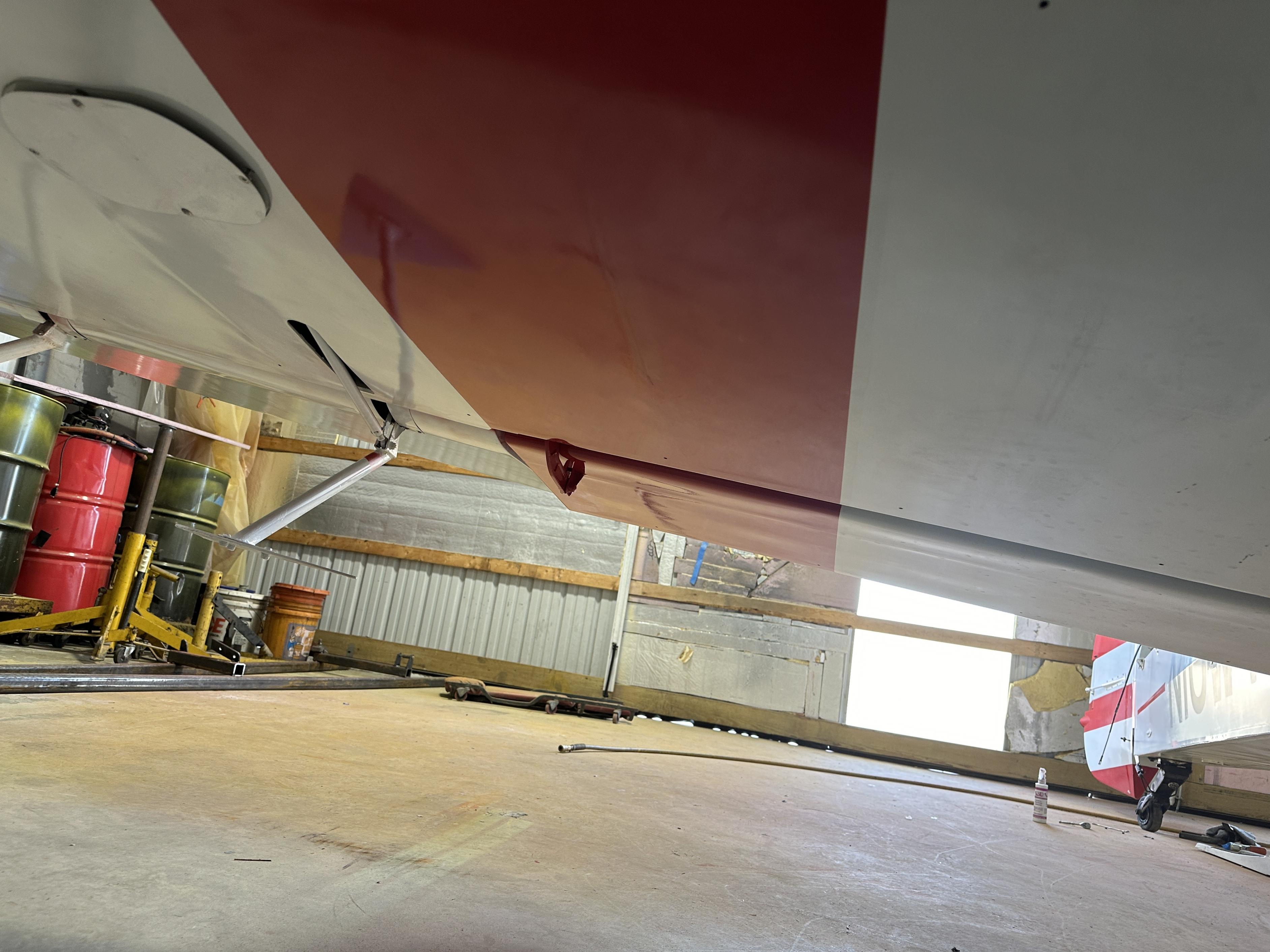

                        Painting the wings and some touch up elsewhere is done.
                        New seat upholstery is back (pics later). Seat belts are back.
                        WOOHOO, new prop was delivered today. A lot quicker than expected.
                        Waiting on new rudder cables
