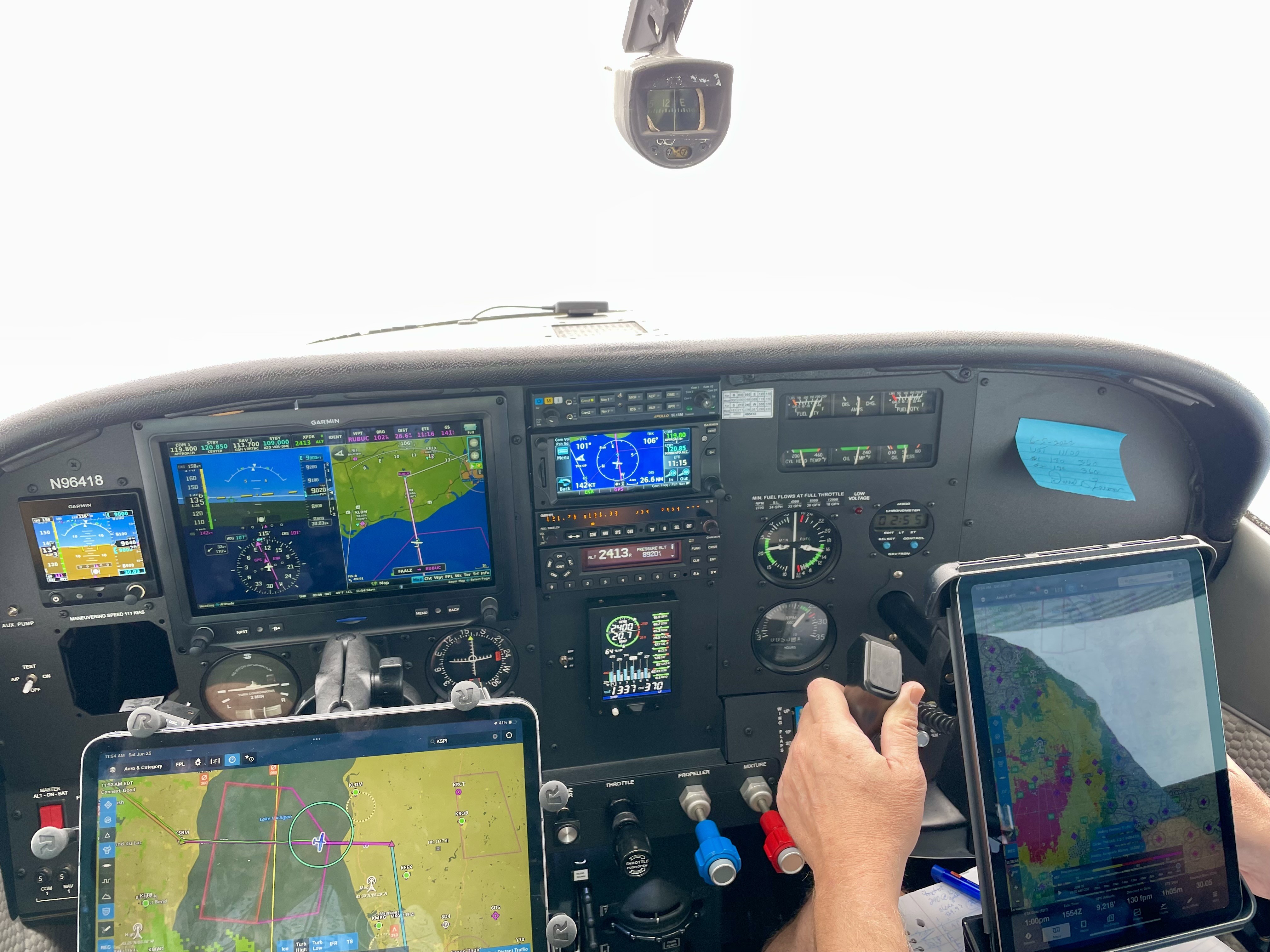

            Last fall, our club voted to do substantial panel upgrades to all six of our aircraft. Our C172's each got a pair of GI-275 units. Very nice, very compact, very feature rich -- still, just two 3" instruments though.
            The C182s and C210s each have (or will have -- only the C182's are done so far) a 10" Garmin G3X Touch, along with a G5 for backup. We've kept the JPI engine instruments, so didn't pay for that feature-set for the G3X. We also already had Garmin GTN650s and GTX345s in each of the six aircraft. We have STEC autopilots in the 6 six-cylinder aircraft.
            All I can say, is the new panel is excellent! Something must have also been upgraded on the GTN 650, and we get new, additional alerts there (such as TOD, etc.). The panel takes a while to learn, and it has many, many options -- even an option to display a standard-looking 6 pack!
            I'm happy to answer questions. Click on the image for full size image.
