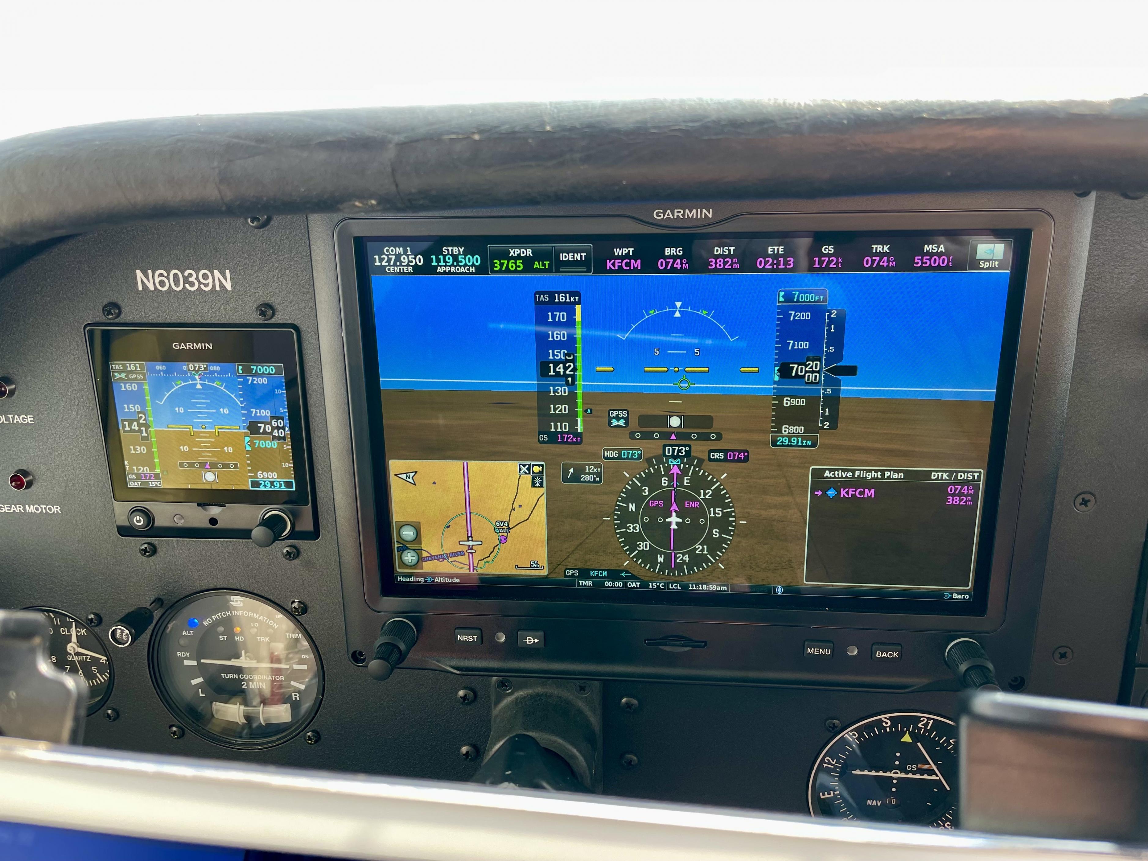

                Terry -- Main reason was that the G3X didn't fit in my panel without structural changes that would have required a DER. Secondary reason is that it's a better display, easily seen when the two are side by side in a classroom setting (Garmin factory training).
                Hmm... We got our G3XTouch into our 1978 210M without structural changes. At first our avionics shop thought that might be necessary, but our A&P figured out a way. We did have to change out the non-structural cover/top of the glare shield to raise it up a bit, and it is certainly a tight fit above the yoke. Having that big beautiful 10" display is really nice!

                        More avionics fam flying today, coupled and with the FD. The muscle memory is getting set pretty well. Tomorrow, a trip under IFR (probably fair weather and that's fine with me), gotta get it in before POTUS shuts our airport for a while in the late afternoon.
                        • #57
                          NICE.
                          G3X? And is that a 7 inch on the right side? I may consider that, but I picked up an AERA 760 for a good deal so thinking a dock for that.
                          What is on the far right? I see you kept a CDI also.
                          Terry - With 5 or 6 hours behind my new avionics now, one of the most impressive things is the EIS. While I've got Garmin, and you've got JPI for now, you probably have the same experience: the analog gauges, fully overhauled and compliant that I flew with for decades are so crude compared to the stability and accuracy of the EIS system. I am in awe of how delightful and easy to use they are. And how much better they are. For example, my MP gauge was always an inch or so off, despite calibration, while the EIS MP is dead-on the barometer. And that's just the tip of the iceberg. If you are still planning on the Garmin EIS, you won't be disappointed.....if you had all the space in the world it would make sense for you to keep the JPI, but the Garmin puts it all together for you on the PFD/MFD big screen.
