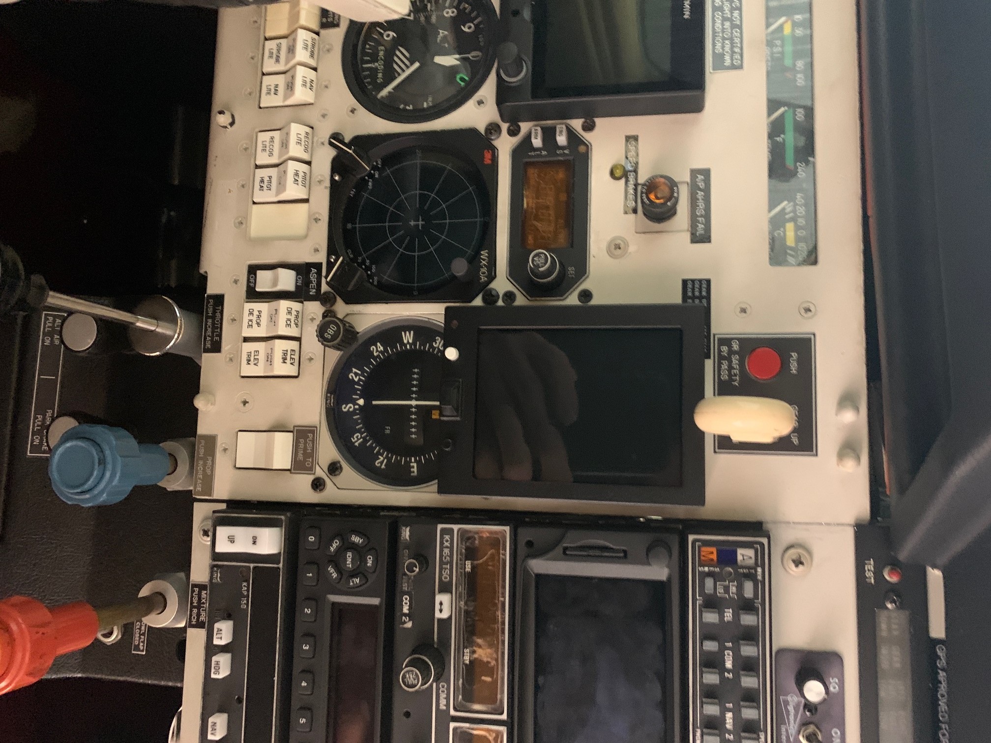

        OK, plane is done. Reading the manual on the 830 to configure it.
        To fit the 830, we swapped the CDI and the StormScope and have the 830 overhanging the CDI. You can still set the reciprocal on the bottom and see the needle and sort of see the to/from flag.

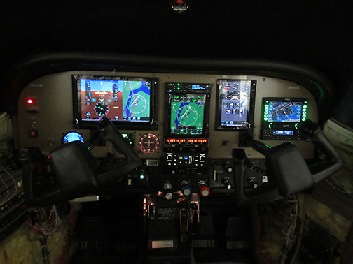

                    I'm looking forward to flying my new stuff after it comes out of annual in a couple of weeks.
Name:	New Avionics 2023 Small.jpg
                    • #40
                      NICE.
                      G3X? And is that a 7 inch on the right side? I may consider that, but I picked up an AERA 760 for a good deal so thinking a dock for that.
                      What is on the far right? I see you kept a CDI also.
                      • #41
                        Hi Terry -- G500Txis, 10" PFD and 7" EIS Far right is an Avidyne EX500 that I've had for years to display the analog ship's radar.
                        • #42
                          Aah, OK.
                          Why did you pick the G500Txi over the G3X?
                          • #43
                            Terry -- Main reason was that the G3X didn't fit in my panel without structural changes that would have required a DER. Secondary reason is that it's a better display, easily seen when the two are side by side in a classroom setting (Garmin factory training).
