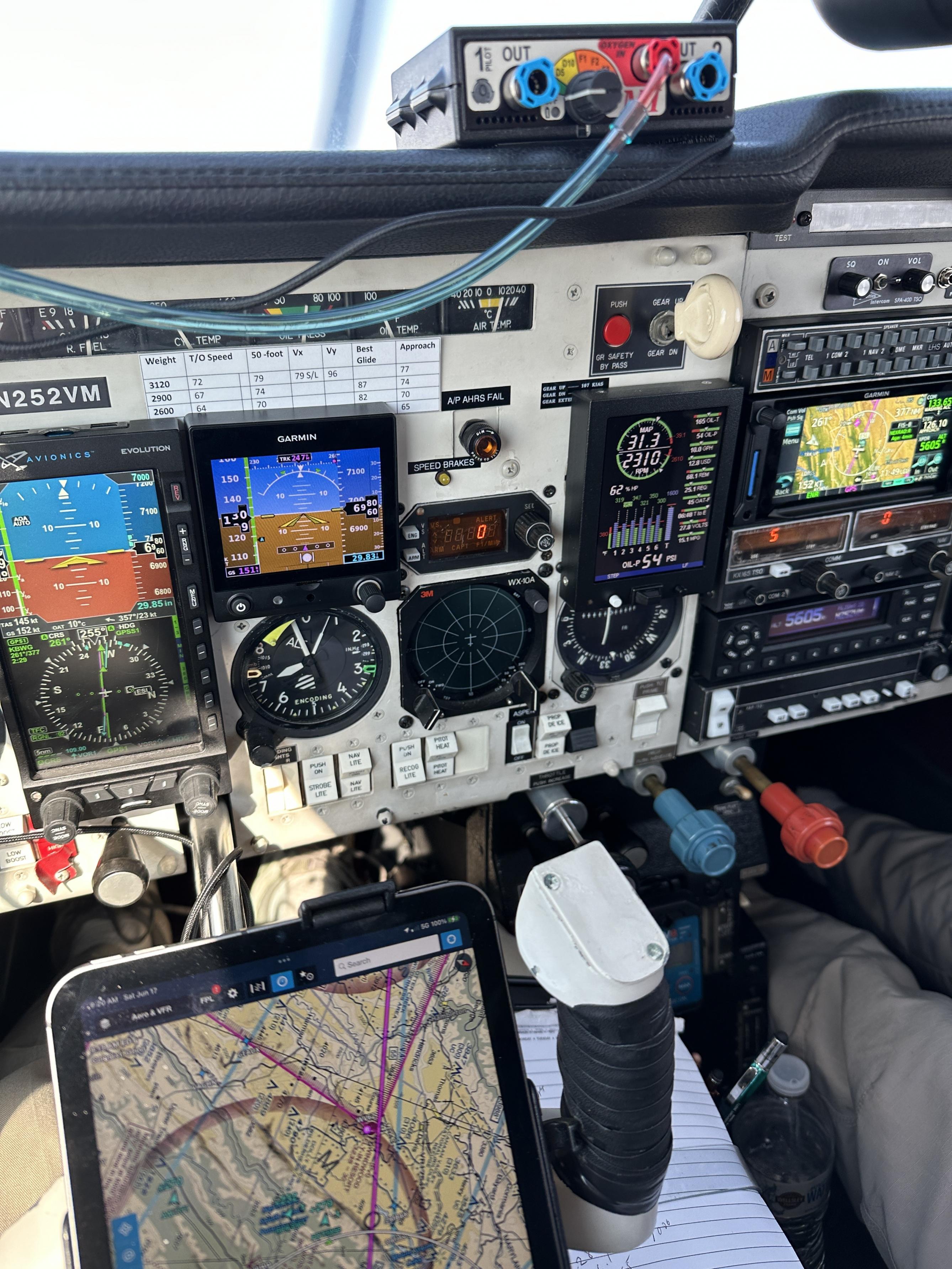

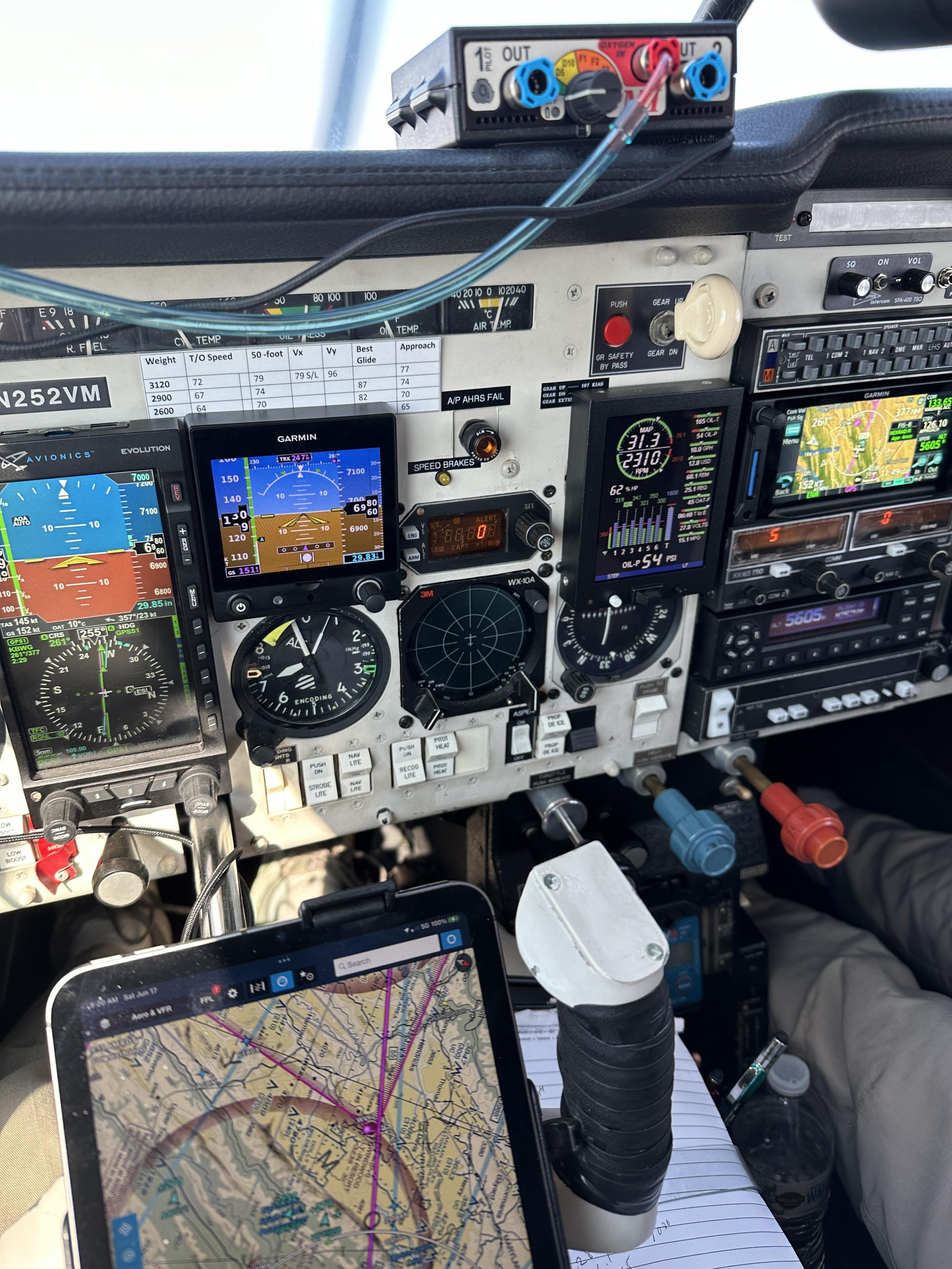

    Below is a pic of the current panel. I have:
    Aspen 1000 Pro (not max) with AoA and Synthetic Vision
    Garmin G-5
    Garmin GTN-650Xi with FS-510
    Garmin GTX-345
    King KMA-24 Audio Panel
    King KAP-1150 Auto Pilot with KAS-287B altitude preselect
    JPI-830
    King KX nav/com (can't remember which one)

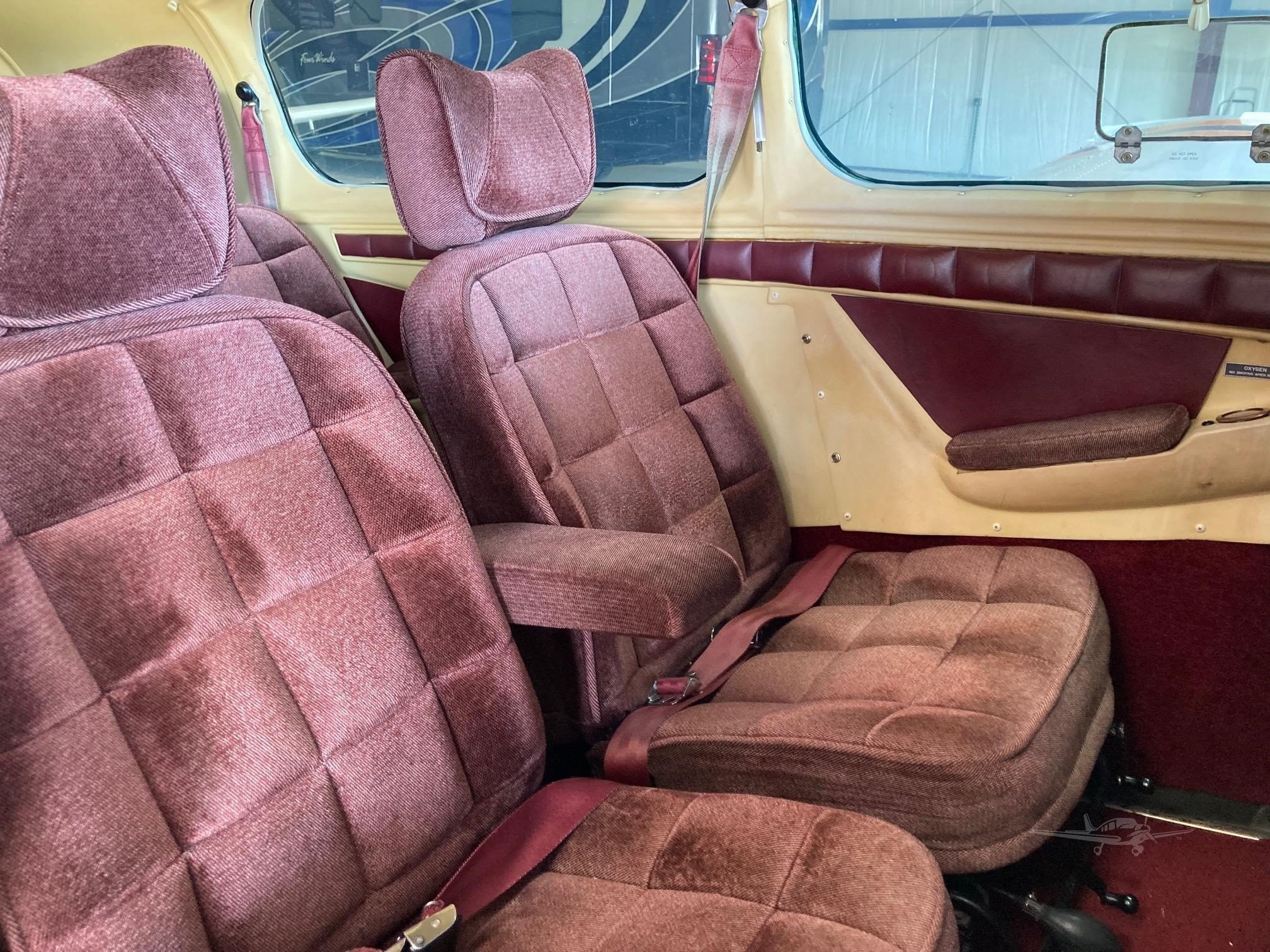

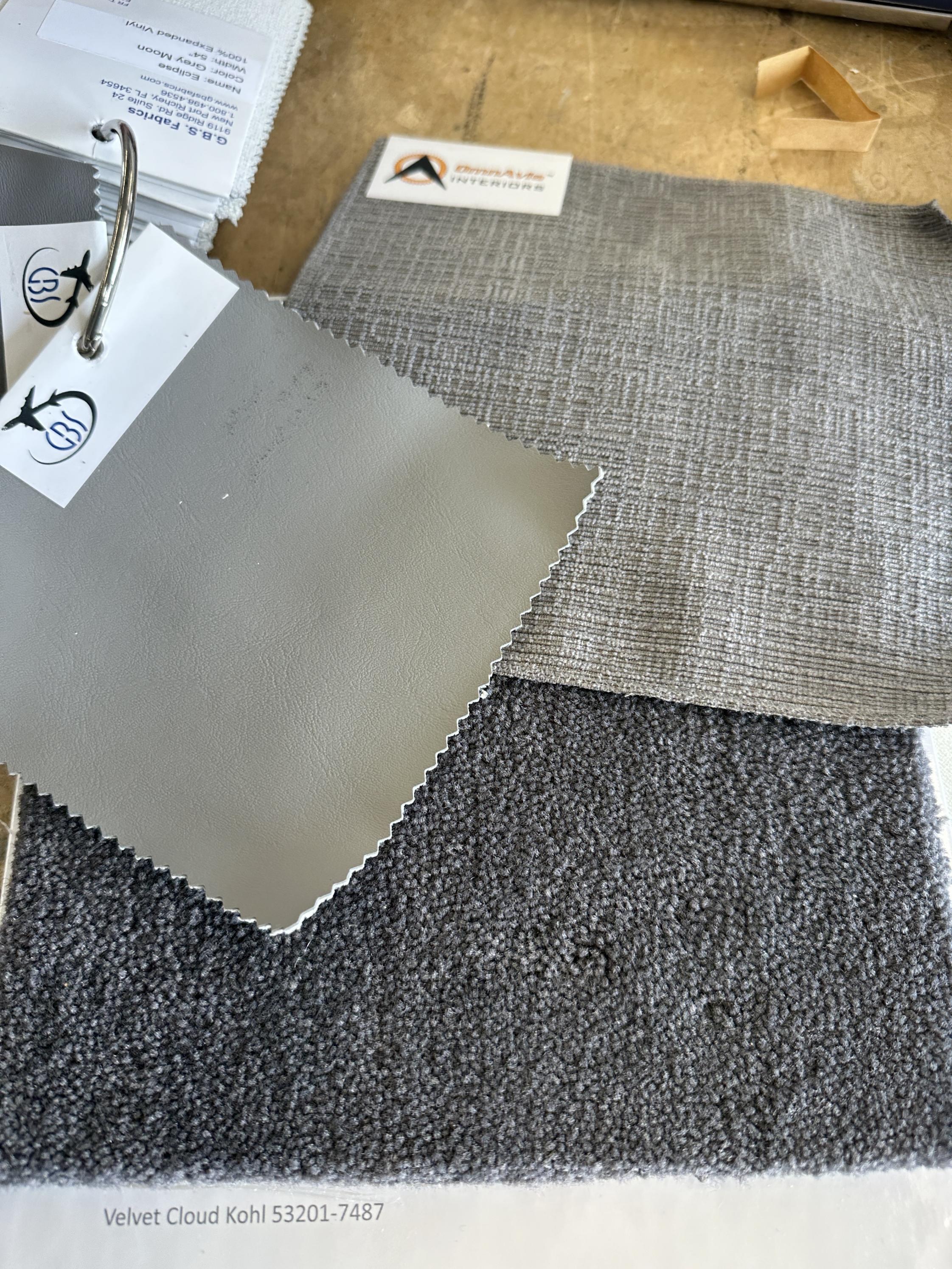

    Also having a nearby shop redo the interior while it is out of the airplane for this work. Picture below of current interior and also the materials for the interior work. In the materials picture, the bottom sample is the carpet, the middle is the seat fabric, and the top is the leather for the side panels and sides and backs of the seats. I am going with cloth seats as they are cooler in the summer and warmer in the winter. The plastic parts will be repaired and painted, not covered in ultraleather. Yokes will be leather wrapped.

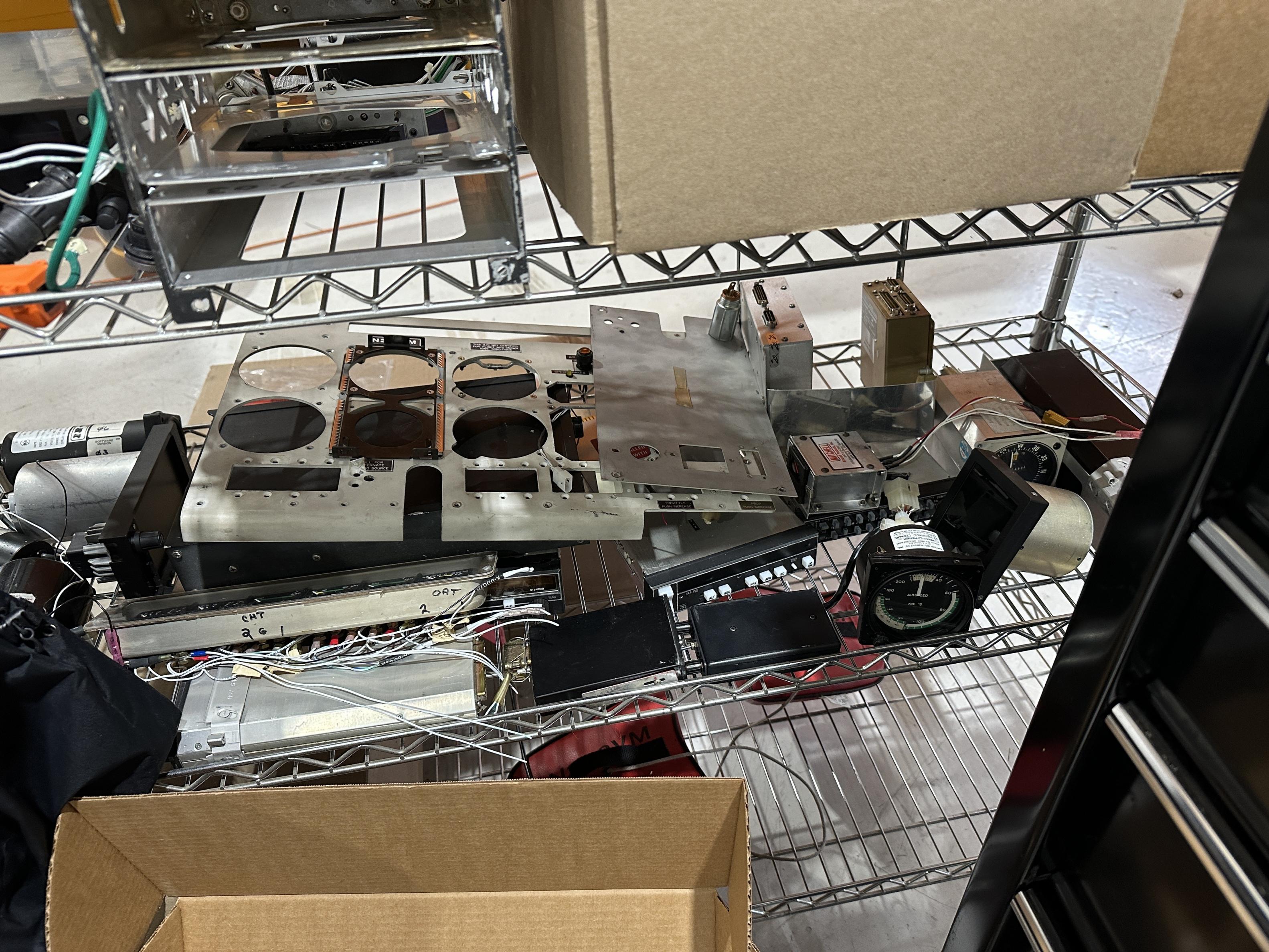

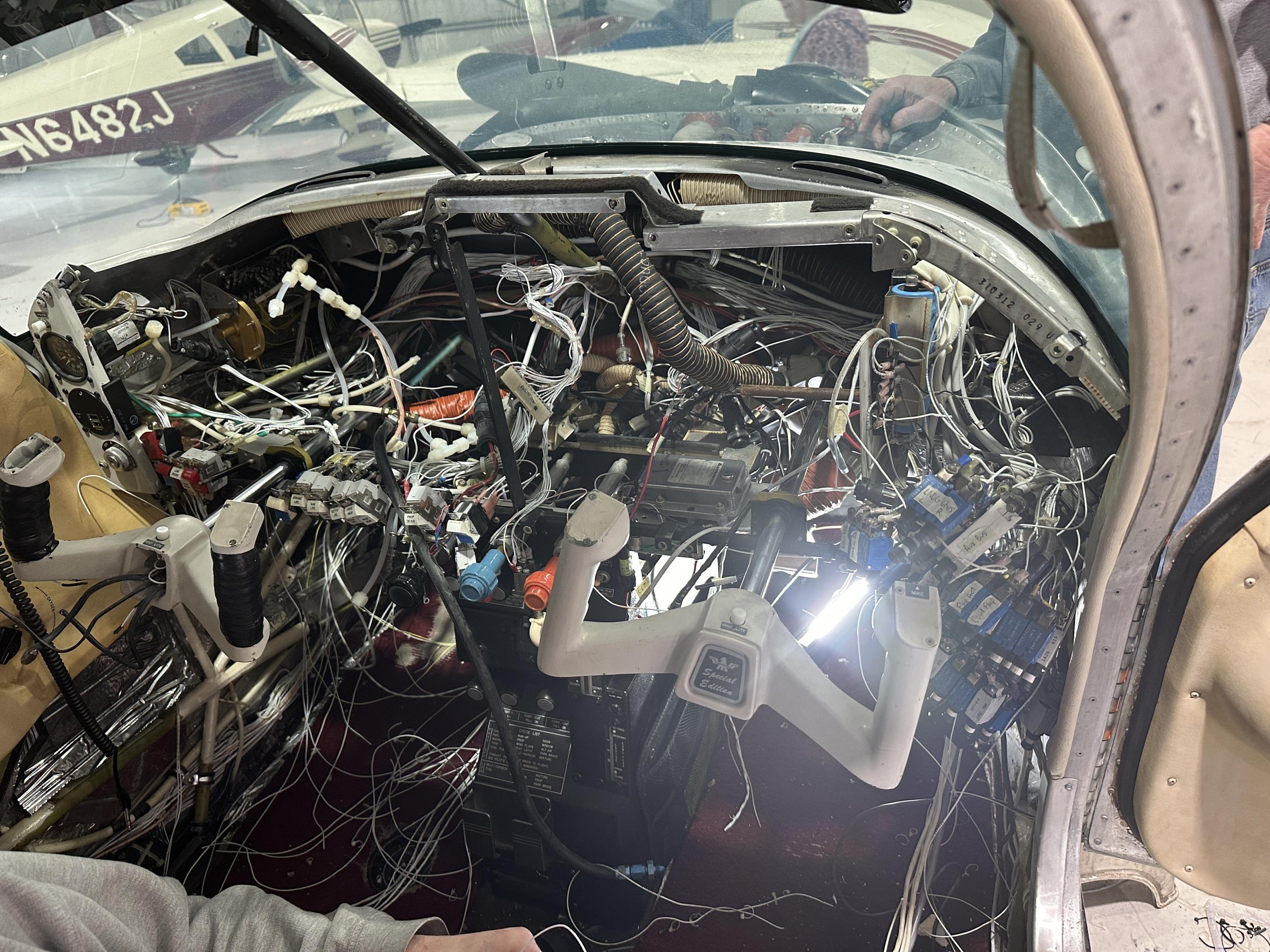

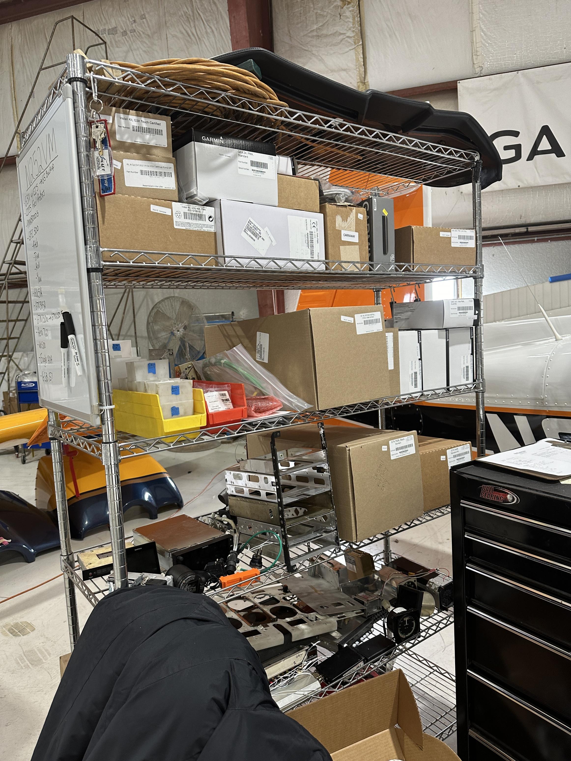

        Work started on Monday. I went to the shop on Thursday to See the progress and talk to the shop.
        Pictures below.
        1) Current status of panel
        2) First box of wiring coming out. They expect 3 more boxes.
        3) The new stuff - top 4 shelves, plus two other big boxes.
        4) All the old stuff
        5) How they keep track of project and install the right things
        One interesting thing, is one tech is responsible for the whole project. With help and oversight, but one person "owns" the project from beginning to end

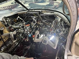

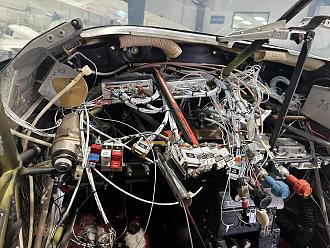

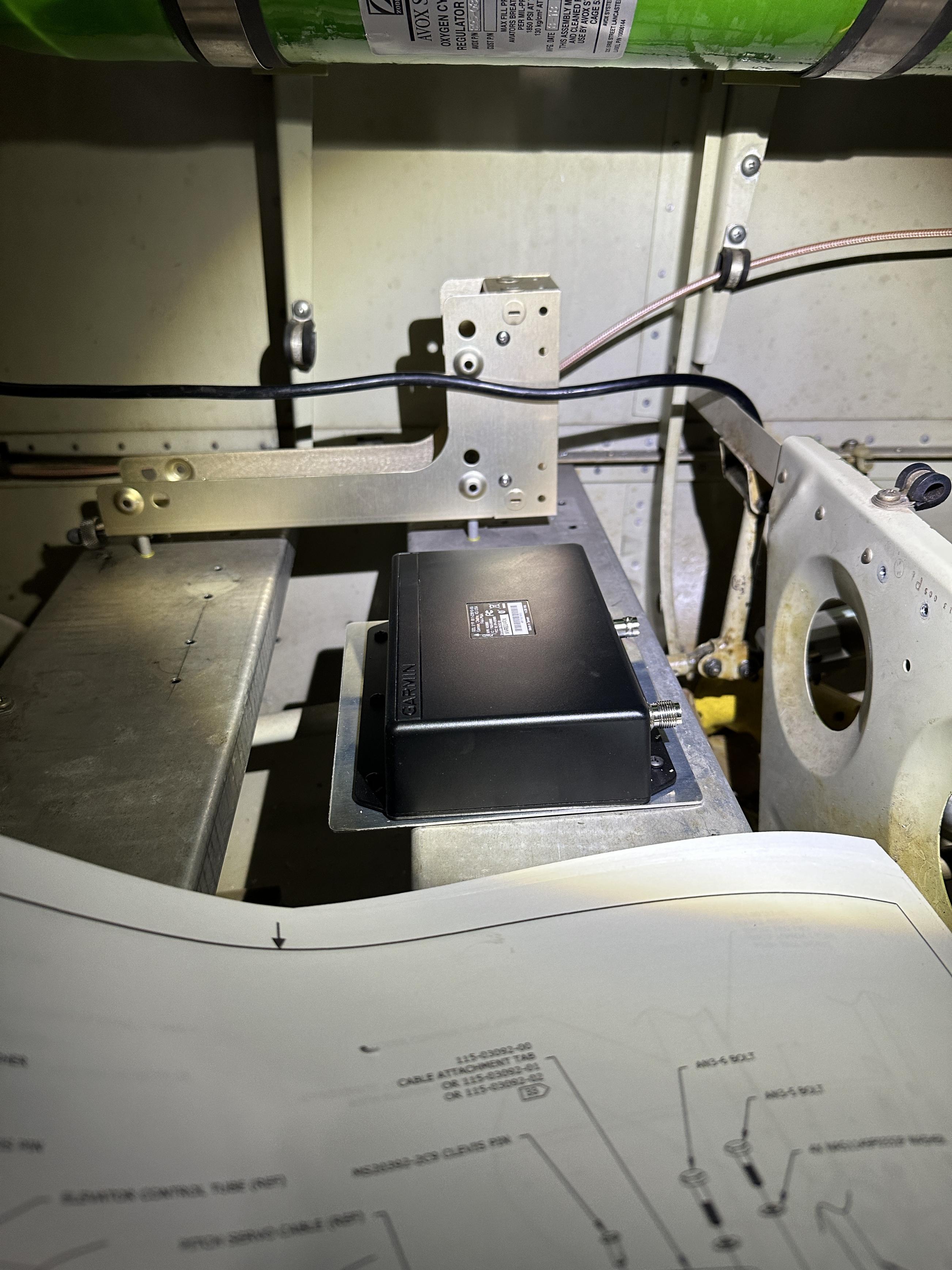

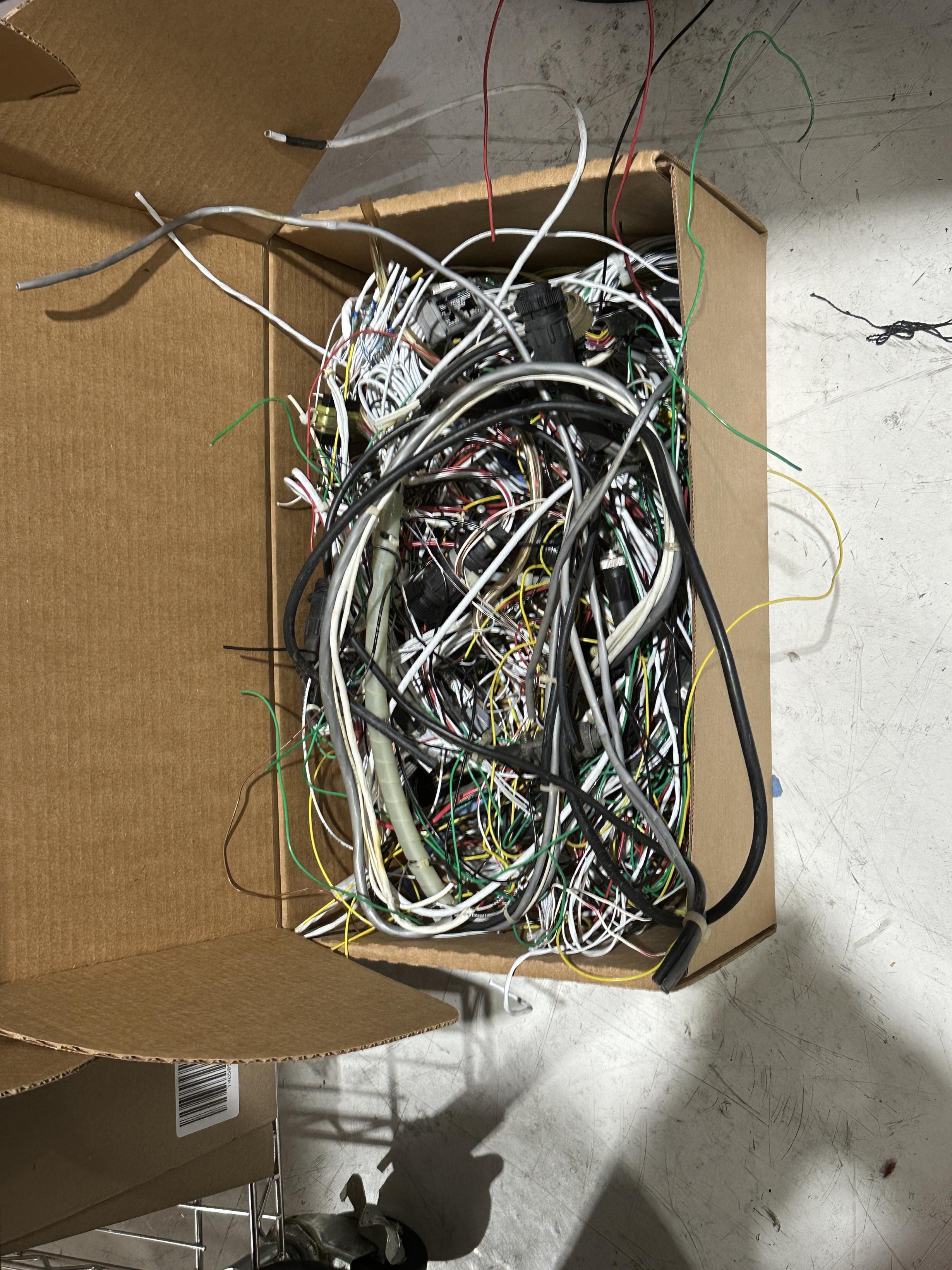

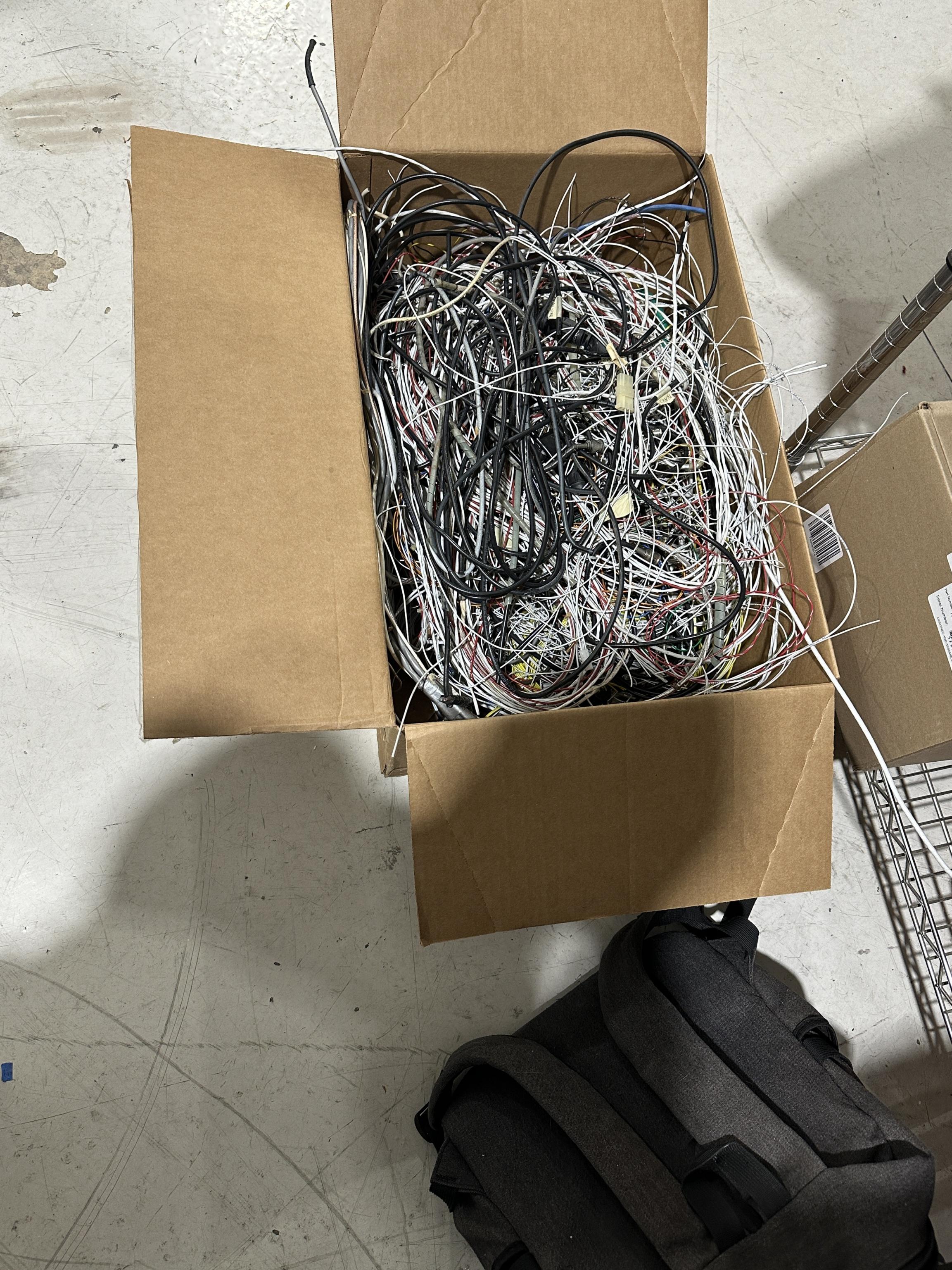

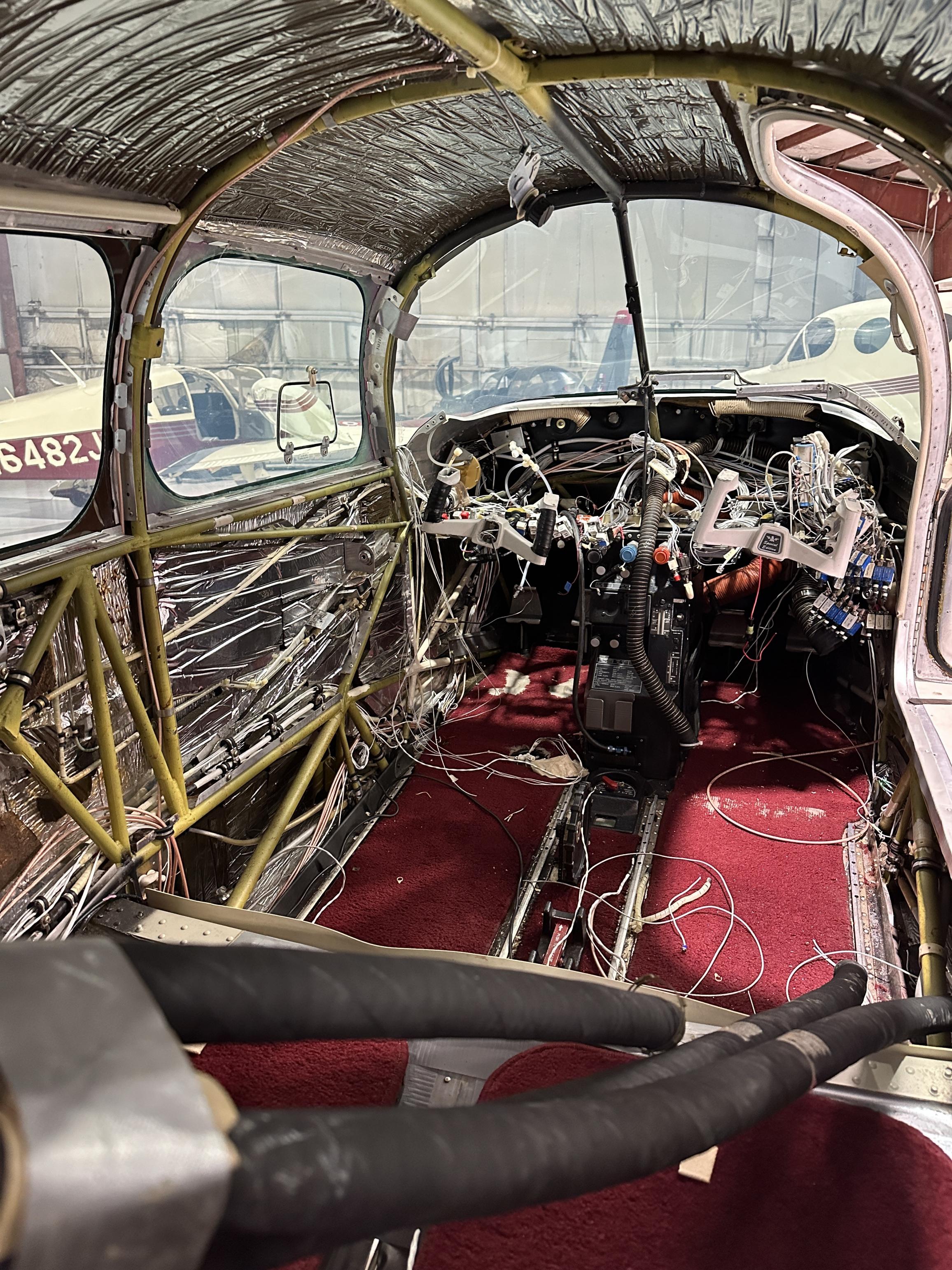

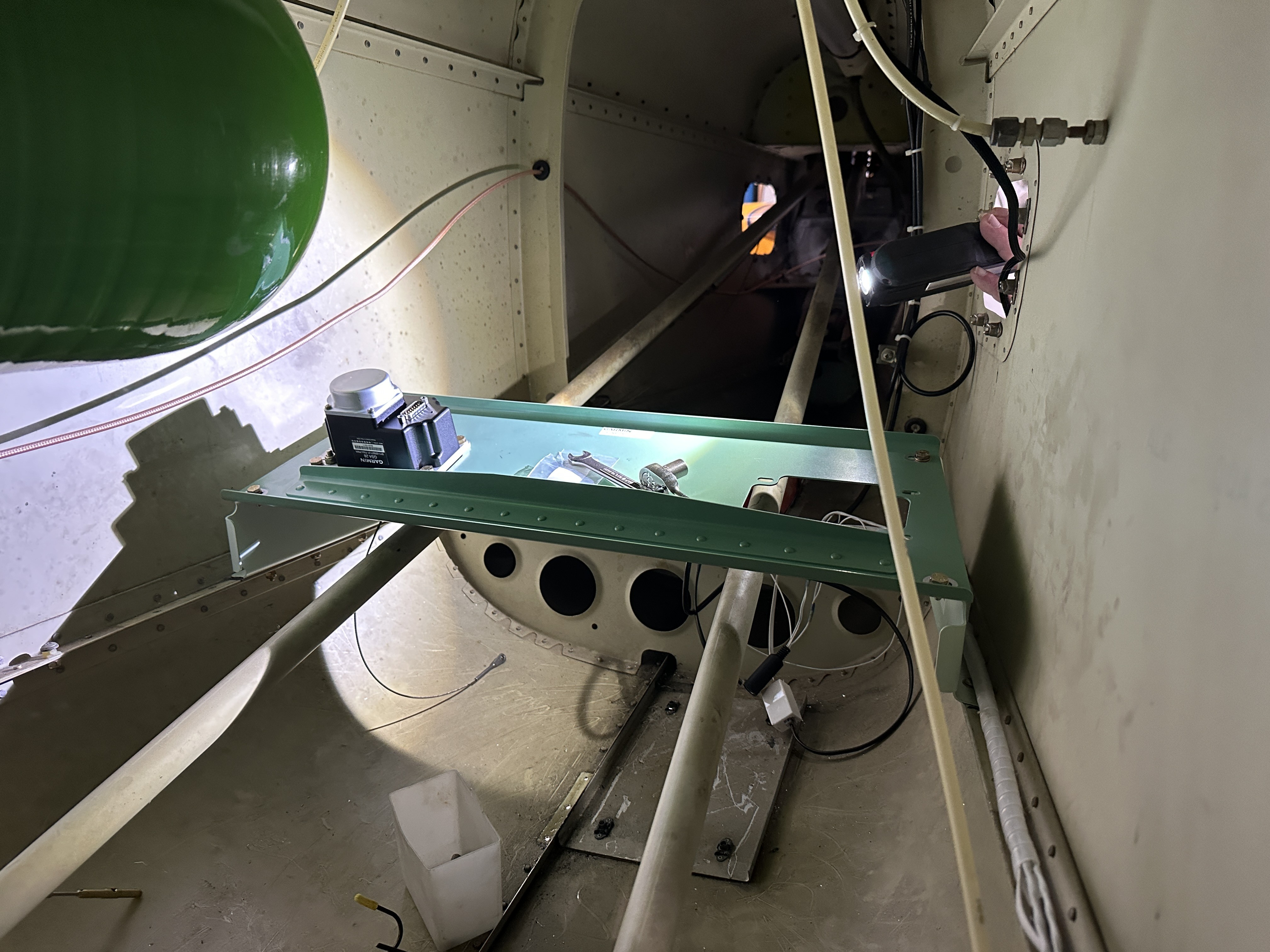

            Update Number 2 - INSTALLATION HAS STARTED
            Went back to the avionics shop on Thursday. They have completed 90 - 95% of the removal of old things and have actually started the install of the new equipment. So far they have installed the WX500 bracket, the GDL-51R Sirius XM receiver and the tail autopilot servo mount and the pitch servo. When I left, the tech was installing the yaw servo.
            The interior shop picked up the interior for that work. Next week I will also stop by the interior shop and get some pictures and update info.
            Pictures
            1) The inside with the interior out.
            2) Current box of wiring taken out. This box is maybe 3 times as big at the one the week before.
            3) Autopilot servo bracket with pitch servo
            4) WX500 mount and GDL-51R (black box)

              Another Update.
              Was by the shop yesterday.
              All the autopilot servos are installed and hooked up to the controls. All the mounts for remote boxes are installed on the shelf. He had just finished replacing the engine sensors (going with Garmin EIS).
              Next couple of weeks will be building wiring harnesses.
              I also stopped by the interior shop. Mainly to drop off the yokes for leather covering. The avionics shop forgot to remove and give them to the interior shop. They have not started on my interior, but they have a while before the airplane is ready to get it back.

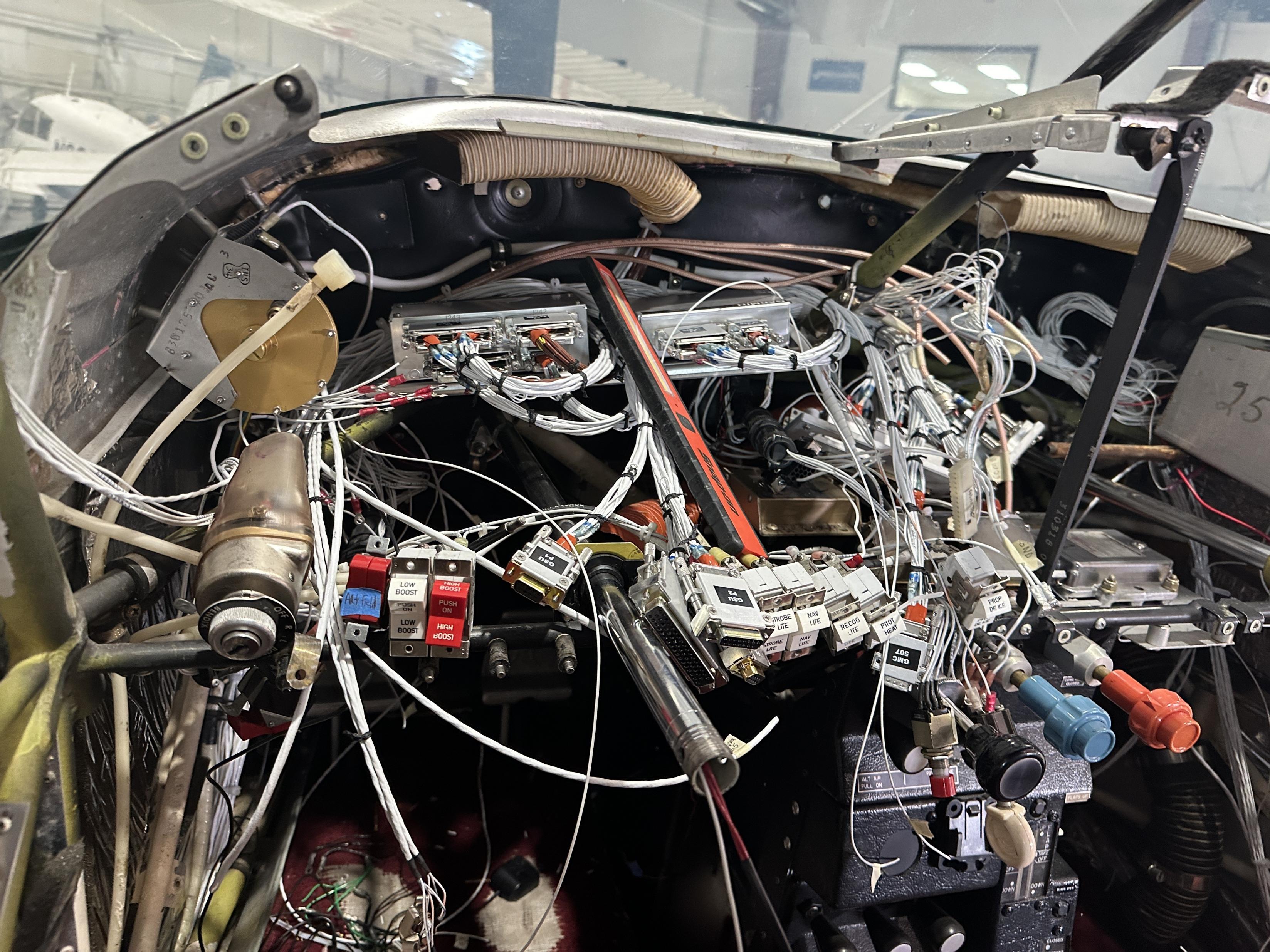

                Stopped by yesterday.
                At first glance, not much different looking. But looking closer, they have mounted several of the behind the panel boxes and a lot of new wiring harnesses waiting to be connected.
                I spend some time with the head guy going over the panel layout. This was basic concepts and thoughts. He will do a CAD layout next week and we will tweak it from there. We covered the main panel items placement. Pretty normal, but the autopilot controller to the left of the stack just above the throttle.
                I am going from rocker switches to toggle switches. We are putting all the engine switches on the left (ignition, starter, master, alternators, boost pumps, primer, prop heat). All the lighting switches will go on the right (beacon, nav, strobes, recog, landing, taxi, flasher). We looked at the annunciators and will get rid of the factory setup as most of them will be integrated into the G3X with EIS. He is getting a quote from Dallas Avionics for some slick rectangular annunciator lights by Eaton. The gear with be a split light with Amber "Unsafe" on top and Green "Down" on the bottom. These will be fully lighted with black letters as will be the Speed Brakes one. The others (Alt Air, Starter Power) with be lighted letters on black.
                Things are moving along.
