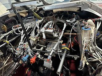

    I was going to so some fancy custom annunciators, but crazy expensive. But it looks like I can use the stock annunciator panel, but repurpose some of the ones that will not be used to handle a few extra things. So Speed Brake light will move to the annunciator panel and add warning lights for pitot heat and prop heat.

      The long middle period where there are more and more wires is pretty much done. The wires have been bundled. Connectors are installed. Shop is working on the panel layout. All the rocker switches have been converted to toggles.

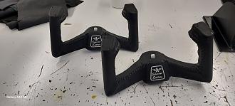

      Yokes are covered in leather by the interior shop and got installed on Friday.
