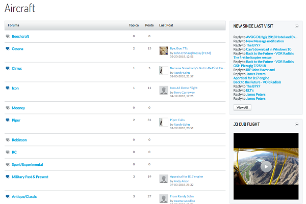

                IT'S BBAAACCCCCKKKKKKKKKK. In Aircraft section, several subsections are lit up, even though there are no new messages.
                This is the first time accessing AVSIG on this computer for over a month.

                  Well, that was interesting. I noticed that the "Aircraft" section was lit up with a new message about a B-17 engine. But when I went into "Aircraft" a number of sub-sections (but not all) were lit up - despite having old messages. I went ahead and drilled down into the "Military Past & Present" section, read the (authentic) message, bounced back up to "Aircraft" and low and behold. everything went back to gray - as it should be. I'm surprised that reading a message in "Military Past & Present| cleared up the sibling sections.
                  Same here.
                  This is the screen shot with the message sections lit, and with it the screen shot immediately after I read Andy's B-17 engine message. Note that none of the "lit up" message sections show in the "new since last visit" section on the right of the screen.

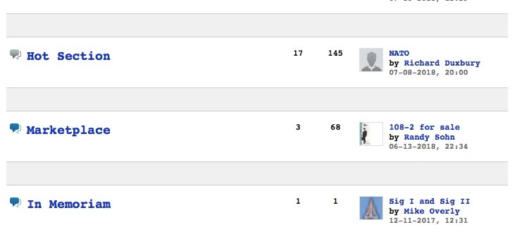

                        • Back again in full force. A number of sections are showing "unread", (Kármán Line +, Drones, Maintenance, Instrument Flight, Medical/Human Factors, FAA Topics, Airline Travel, Flight Sims, Marketplace, and In Memoriam - I've only listed sections with invalid "unread" flags). This appeared in my Edge browser. It wasn't an old session. I just opened avsig and boom. My phone is logged out. My work machine may have a session open, but I was using it yesterday. There shouldn't be any other active sessions. So, I can't see how this is stale session data.

                              The tab was closed, so there was no open sessions when this happened. And I'm seeing the same thing (false unread sections) on my work machine. So it's not stale data in the browser, but false information coming from the server.
                              And this is at least the second time it's happened to multiple people at once.
