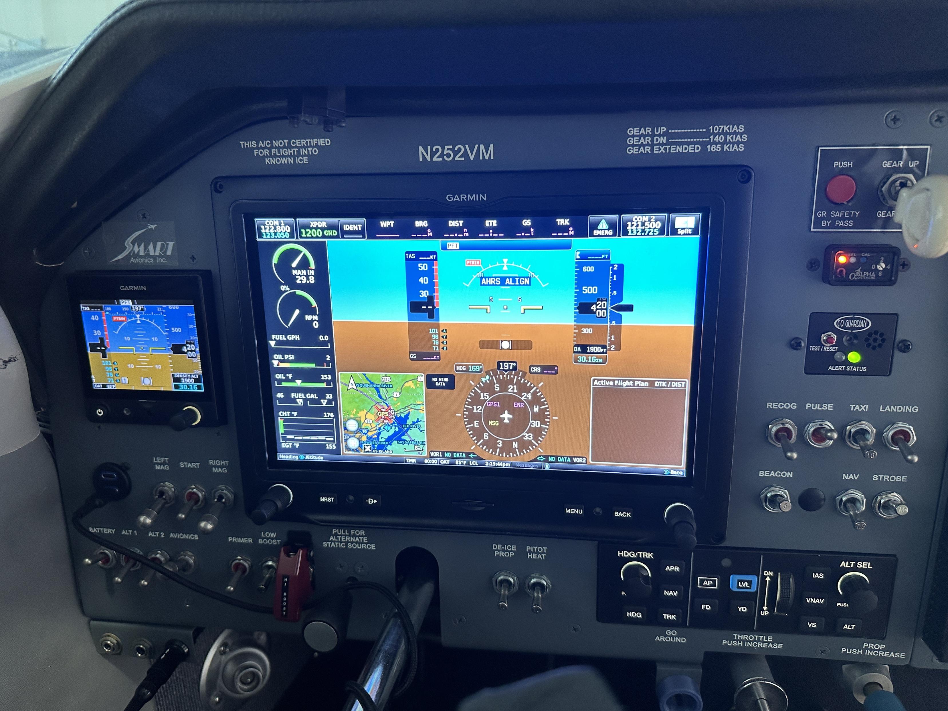

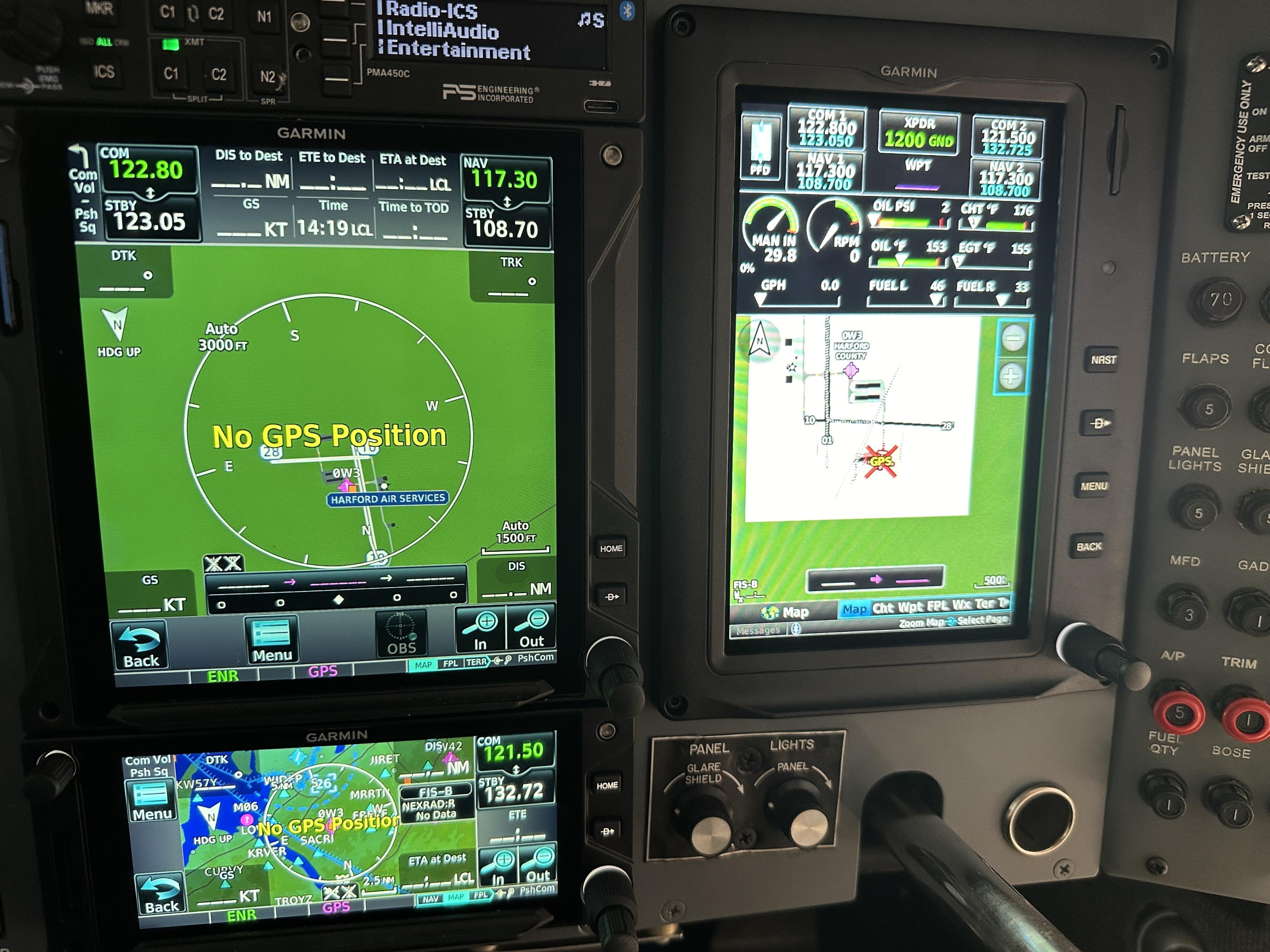

                  Here are pictures of the finished job. Having a few weird things, but one two "major" items.
                  1) TFR/restricted not showing on the G3X or the 750. They are getting FIS-B data, as I can see traffic and weather. Also, no weather on the Airport Info tab on the G3X.
                  2) Fuel flow/fuel used is whacked. But a local mechanic (works on the CAP-10) said he ran into flow sensors with a K factor around 60,000. And that range should make my numbers good.

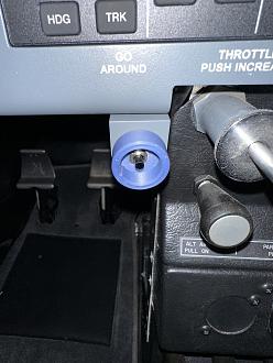

                  I do want to point out the picture of the very special TOGO guard. John did it 3D printed. I have extras if anyone needs one (Scott?)

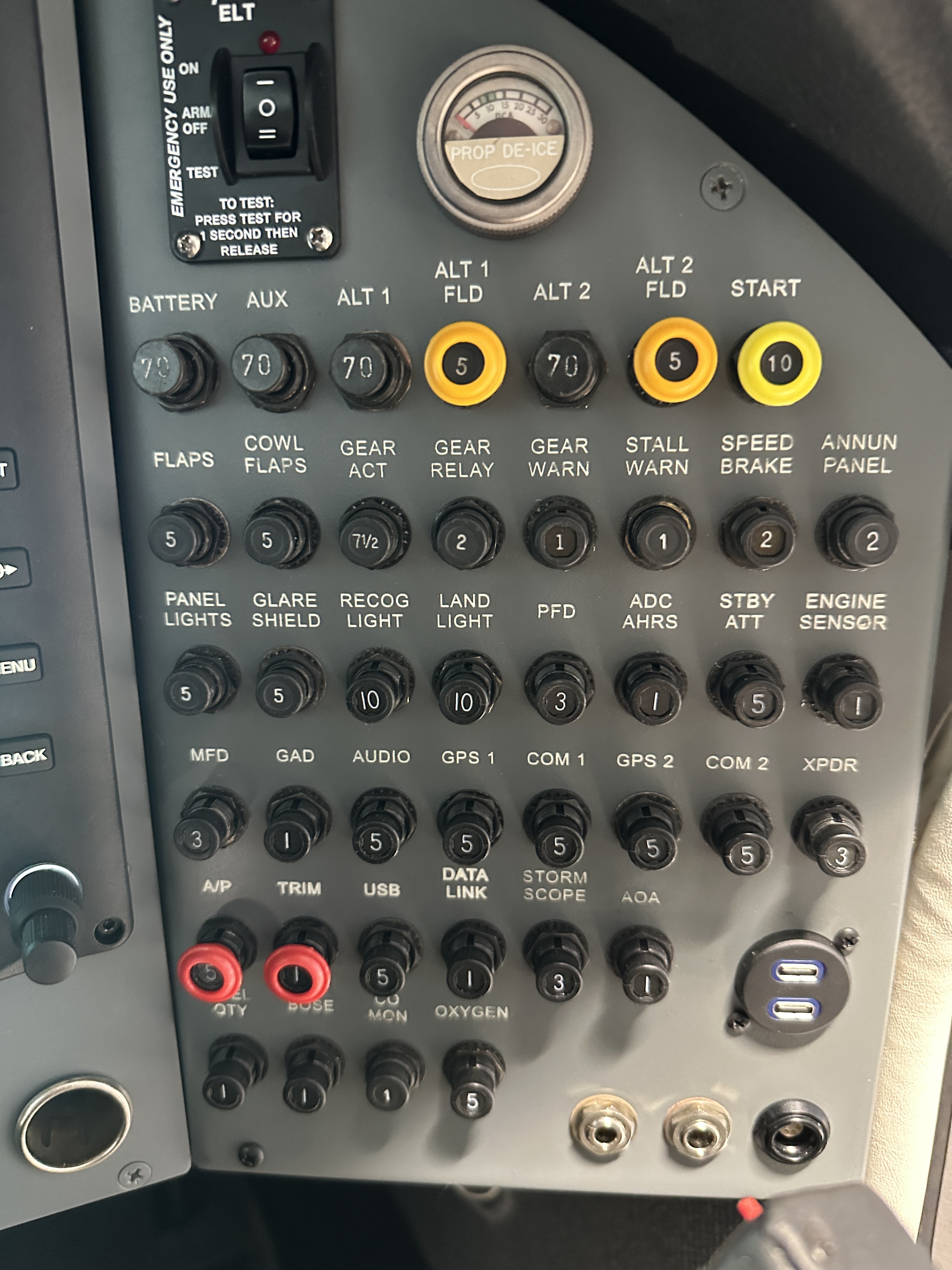

                        One more question for everyone.
                        I put colored collars on the AP and Trim (red), Start (Yellow) and Alt 1 and 2 field (orange.
                        What other CBs should be highlighted?

                          Very sharp! I doubt I'll ever own again but if I do, M20 is at the top of my wish-list.
                          What does the "Go-around" button actually do? Strictly avionics?
                          • #73
                            If AP is on, it flies 7 degrees nose up and wings level.
                            If Flight Director is only on, it commands the same
                            For TO, it gives you some FD guidance for low IFR until you are high enough to engage AP (min 800 AGL) and start following a heading or your course.

                            • #74
                              I wouldn't collar any others, keep it simple.
                                When I was flying Cobras in Vietnam we would put safety wire on the armament system circuits breakers. Instead of trying to find the circuit breakers all we had to do was pull on the safety wire.
